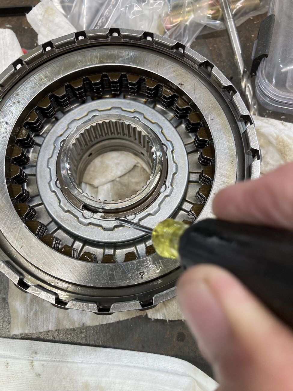

  2. 1000-3
Pick or small screwdriver. They don't have alot of tension, so lift one edge and pull it out by hand.
I'm referring to the small lockring, although I realized when replacing the whole clutch assembly you don't have to remove that one. Another question, which way does the entire assembly go in when reassembled? One of the clutch packs has more space between it and the primary driven gear. Also, the primary sub gear has no tension on it. I'm still not real clear on loading or tensioning (whatever it's called) the primary drive gear.

Are you referring to the ring inside the clutch cover? The one that holds the collar?
This one.
Lock ring

You dont need to remove that one unless your separating the clutch pack itself, which you'd need the special tool to do so.
That's only really needed to clean behind the piston, but if the clutch is bad, you get the entire assembly.
I figured that out. If you have a moment, could you help me out with the other two questions I asked in the same post? I really appreciate your help!
