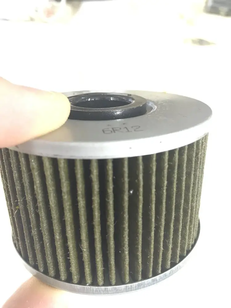

Thanks for this walk-through. I used it myself. Lol. Changed mine tonight.
Thought the filters were a little dark. But I have been having some alpha clutch high revs. I think we know whats coming with that.
Left filter is just for comparison.
5a0db41ed8d4be94490b0d577391dd6e
Uh oh..

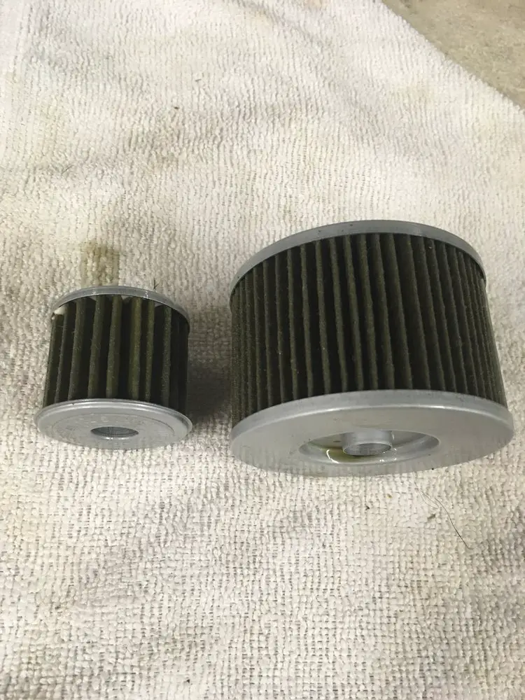

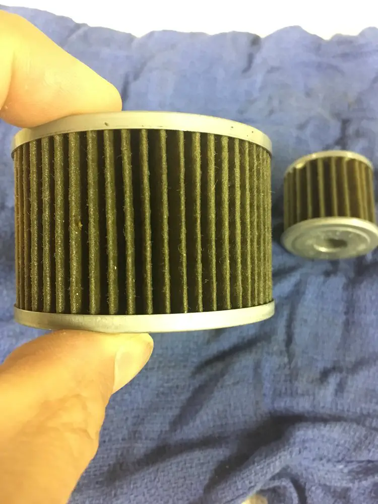

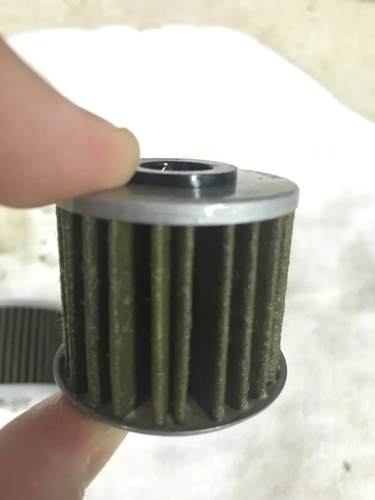

Nah. Don't sweat it. I have 10.5 EAZY hours on my oil filters... they looked about the same.
Oil was clear. Filters were dark in color. (You're gonna make me get out of bed and go take a picture of them)
I just walked across the yard in my underwear and a pair of my son's Crocs for you. Cellphone in hand!
IMG 4389
IMG 4390
IMG 4391
IMG 4393
IMG 4394
It's all about white balance and camera exposure... the same filters shot against different color backgrounds.
PS... I dug them out of the trash can. So there's more foreign crap stuck between the fins than there should be.
View attachment 38815 View attachment 38816 View attachment 38817 View attachment 38818 View attachment 38819
Just thought about this... still think your filters weren't telling you what was to come?

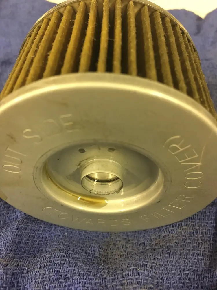

First Oil change complete! Went relatively smooth. Filters didn't yield anything to alarming. 7434f4c3ffbe1e0ae454e58196c50f76
