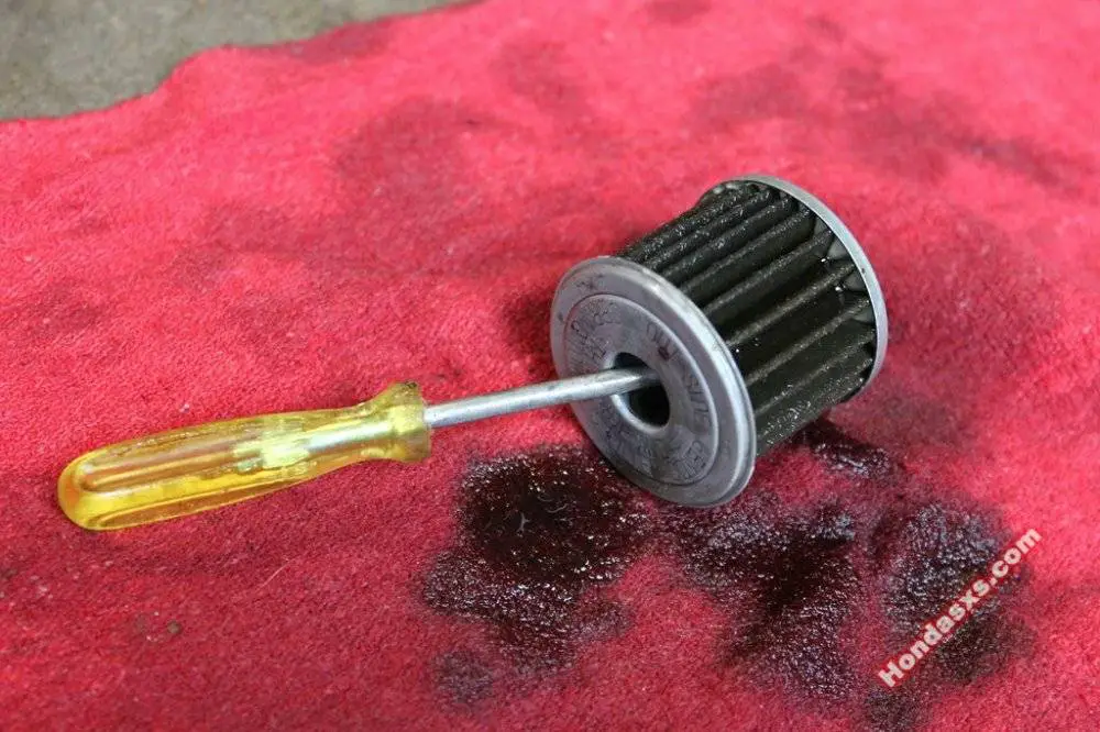

Question - is anyone actually checking valve clearance, and if so, how (in lay terms)? I called my dealer this morning and they said 20 hrs / 100 mi is too early to check the valves so they weren't doing them until the second service (I assume this is unofficial).
drfubar
drfubar
TheDonFather
Jun 7, 2016
5,889
19,242
Mary's Ridge (Dayton Mtn), TN
Actually yes.
Stick a screw driver in the spring hole. Otherwise.. Yes. It's a PITA.
Instead of a screw driver I used my little magnetic wand... Shop Hillman Telescoping Magnetic Pick Up Tool at Lowes.com
I used this also for getting the oil pan plug out because my fingers wouldn't fit that well in the access hole in the skid plate. Oh, and I used it when I dropped one of the springs too...:)
It's a handy little bugger
