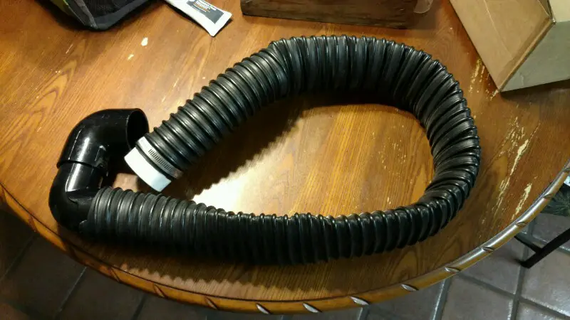

Yeah it came Saturday. I have to work some overtime today but will put it on tomorrow. Here's a pic out of the box. Nothing much to it. I'm sure I'll modify the top section and add a ram type scoop.Hey buddy did you get your snorkel yet ?
Yeah I told you is pretty simple but man it works yes they definitely use the right hose that's some good hose there I kept mine behind the head rest because I like the look of it, just can't even tell you have a snorkel and it's not in your way when you turn your head when your a passenger you should probably try it out like it is and then figure out how you want it later I have the same thoughts in the beginning and I like it like it cameYeah it came Saturday. I have to work some overtime today but will put it on tomorrow. Here's a pic out of the box. Nothing much to it. I'm sure I'll modify the top section and add a ram type scoop.View attachment 12204The main thing I wanted to get my hands on was the hose. Several have tried n failed to get something to work between the bed and seat. The hose is very sturdy and won't collapse from the engine breathing. If you can find the hose, you could probably build this for under 20 bucks lol.
I'll try it as is and see what I think. Thanks for all the info manYeah I told you is pretty simple but man it works yes they definitely use the right hose that's some good hose there I kept mine behind the head rest because I like the look of it, just can't even tell you have a snorkel and it's not in your way when you turn your head when your a passenger you should probably try it out like it is and then figure out how you want it later I have the same thoughts in the beginning and I like it like it came
