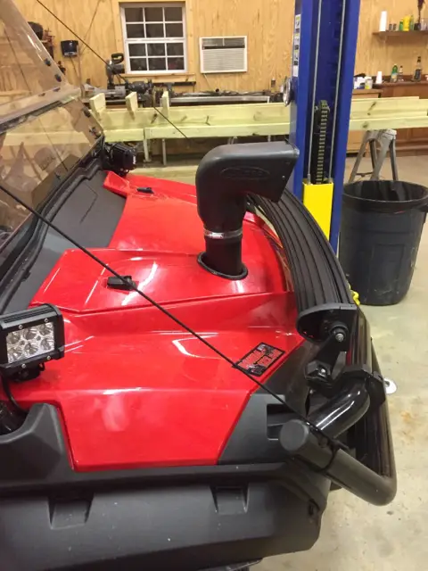

Consider a snorkel like I did. It's stupid simple and can be reverted back to stock in minutes.
I watching some of your videos on tube that just the snorkel thAt making the deep sound I hear? Where you get the top piece for the snorkel?

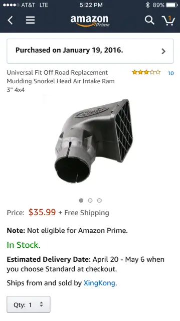

The engine noise is from the intake. It seems to breath better with it. My camera is mounted pretty close to it.
Here's the Amazon item I bought
That's what I'd like to eventually get for my kit. Seems all the really cheap ones come from China on eBay lol.
