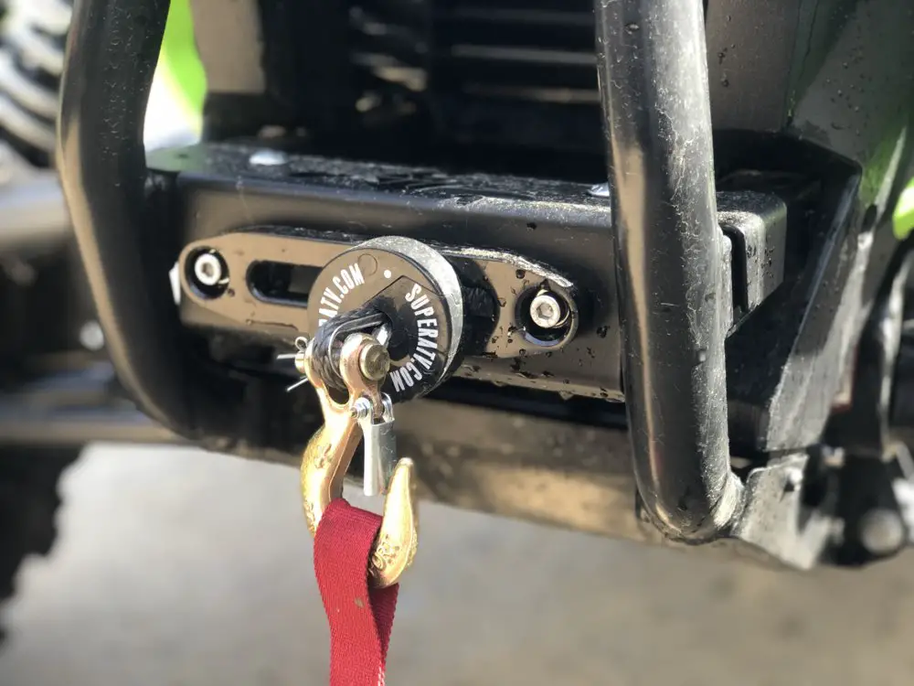

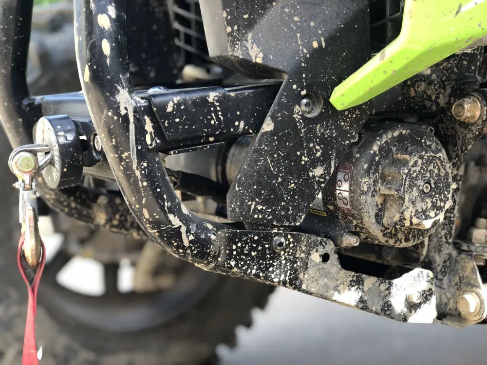

We've installed a 5500 Warn Axion on the stock bumper using the Honda mount.
I think its just normal Honda over engineering and cautiousness, and possibly greed to get you to buy their bumpers, lol.

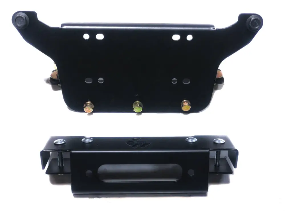

Which winch mount would that be?
H
HondaTech
That’s the expensive one. Is there one that’s less expensive, won’t have to be massaged, and will work with the Axion 55 on the Talon Fox 4?
Ive only used that one on any of our winch installs, most of them have been the Honda branded winch as well. The only Axion we did was a friend of our GM who purchased our first R model. He'd already gotten the Axion before the Talon dropped.

I just got my Talon 1000X three weeks ago and decided to go with the Warn Winch Bumper/Mount 104300 with the Axon 45.
I like the added protection it offers the front diff with the heavy duty skid pan.
