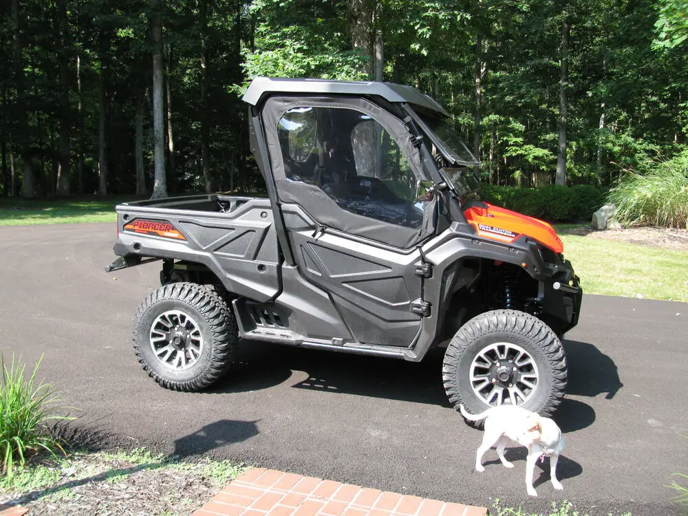

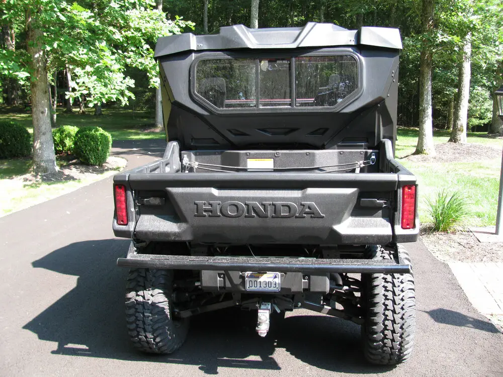

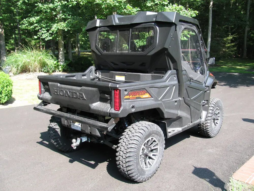

I recently installed a set of four Tensor Regulator size 28x10x14 on Pioneer 1000 LE wheels. The tires are DOT approved 8 ply rated and pretty stiff. The P1K3 rides, drives, and handles well with the tires on dry pavement but it seems a little skittish on smooth wet blacktop.
Tire inflation pressure is around 21 psi and the tread surface looks flat to the naked eye but I'm not sure I have full tread contact with the road surface.
I'd like to try a little lower inflation pressure but don't want to risk a sudden deflation in a curve at 45 mph due to a tire bead losing it's seal on the rim. I don't do any trail riding or rock climbing so no worry about a rock breaking the bead seal.
These tires are probably molded with a hard rubber compound and never going to have the wet pavement grip of Michelins or other high quality highway tires so lower inflation pressure may not help.
What do the experienced owners recommend for inflation pressure?

I run the exact same tire on one of my P1K’s and off road I keep 12-14 psi with great performance in all off road surfaces. I run 28-30 in them on my overland treks when hitting lots of asphalt and hard pack county roads. Keeping a compressor on board, I have had to deflate and reinflate according to conditions. And as a bonus, these tires wear very well……

Thanks. It's good to hear from a member with experience with the same wheels and tires.
I had a physical therapy appointment this morning and drove my buggy (which s now my car). I deliberately pushed hard on curves. The ride and road grip are noticeably improved at 18 psi on dry pavement.
I'll feel more confident reducing inflation to as low as 14 psi since no one is reporting surprise deflation.
