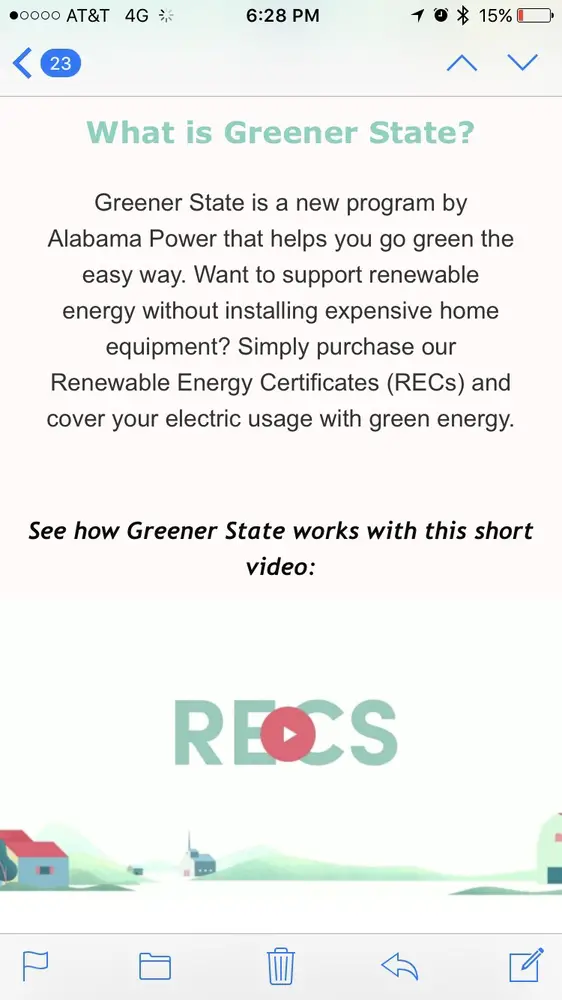

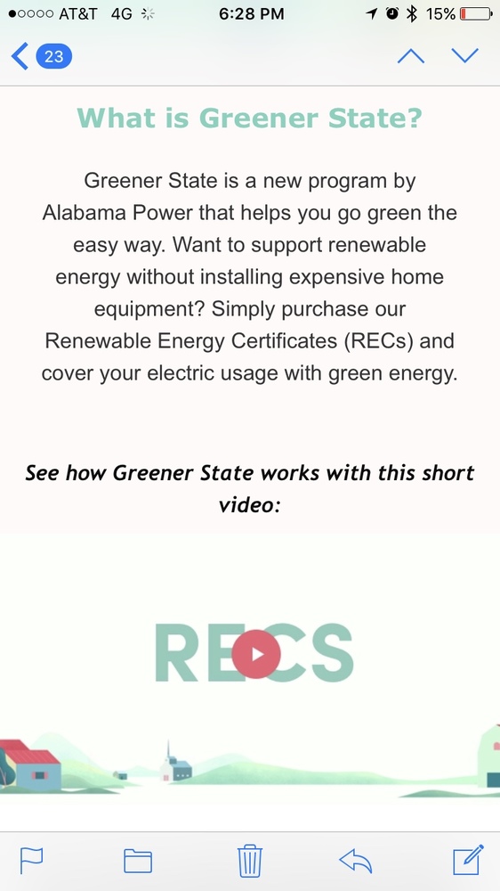

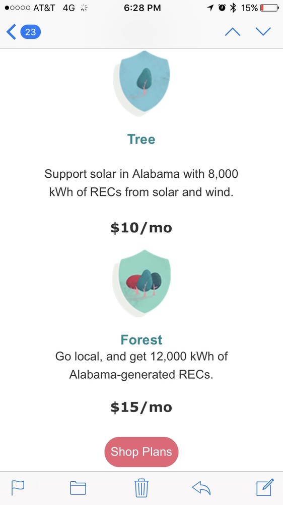

AlaPower only gives you .03 per kWh but they charge .13per kWh, net metering is BS!!! They use the excuse that they have to maintain the grid more when net metering is in effect.
AlaPoCo just started trying to push GREEN kWhs by charging you MORE for the fuzzy feeling of using that you're using GREEN energy.

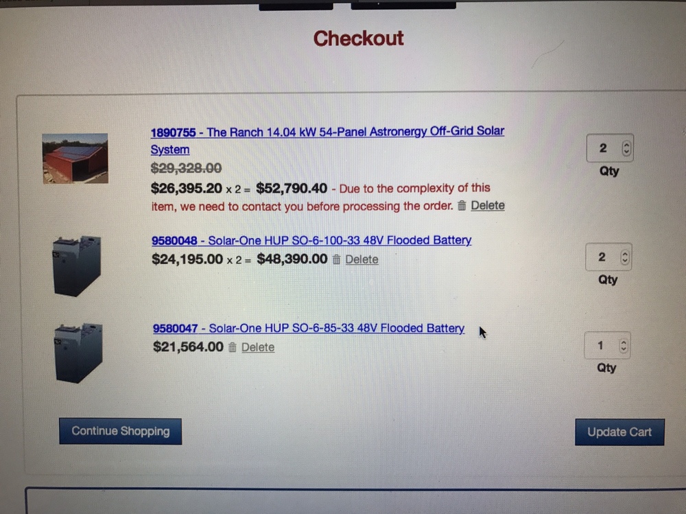

This is just PARTS to run our house with no gen or grid for recharging and 2days with inadequate sun.
