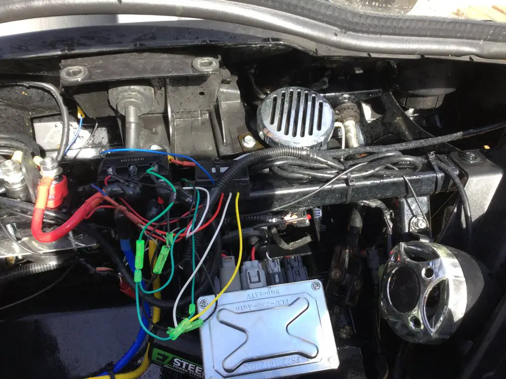

so for Christmas I got the following items for my horn install. I need some help wiring it up.
I have the Accessory Harness so I want to use that to connect to the switch
I have a winch and I want to steal power from where the battery connects to the solenoid to power my horn. I do not want to run power all the way back to the battery again
From what I have read I think I am suppose to use the Yellow taped wire from the Accessory Harnas to connect to the switch.
Not sure if there are one or two wires in that bundle or not or what post they go to on the switch
I have a fuse holder I think I should connect it to the positive side of the solenoid where the "+" Connects. then connect the other end of the fuse holder to the relay. #30 pin
I Don't know much of anything else. Is this a Positive trigger setup or a Ground trigger setup.
where do all the other wires go?

Is this the correct way to wire it?

Mine did not need a relay and guessing your smaller horn will not. Just checked, one horn lead hot via button, second horn lead ground. Mounted bracket to an existing P500 bolt. Mine is a bit different looking horn. Only needed a relay on a bigger air compressor horn which was on my motorcycle. Good luck and welcome to forum.

I was afraid to power the horn from the accessory Harness I though the harness only had enough power to trigger the relay and light the button up. I didn’t want to cook any factory wiring.
I appreciated all the help from this forum
Gary

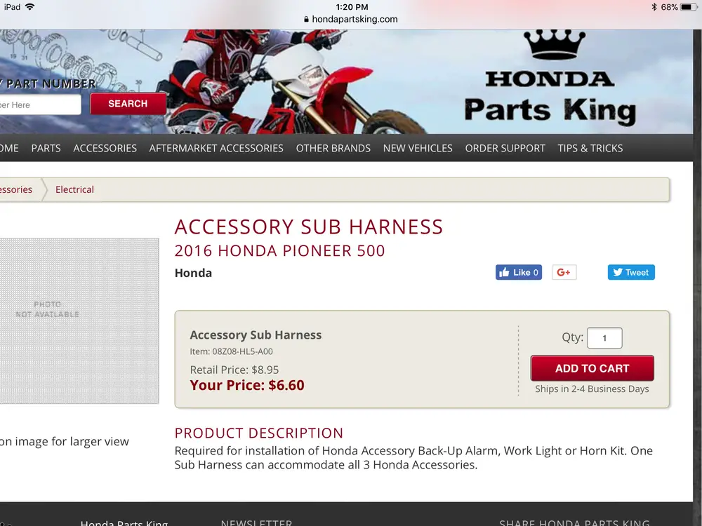

Your horn only shows 1.5 amp. Honda OEM Harness description shows it can power all three accessories, horn, back up alarm, work light. Hope this helps simplify the installation.
Thank you that made it a lot simpler to install.
