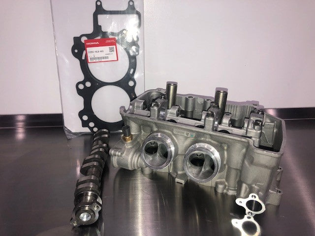

I don't now how much the machine shop took off, the pistons are not fly cut they did not want to mess with it they just took a little more off then necessary when planing the head they said they did not go out of the safe zone for clearance so that equates to not a lot.
If you need a good replacement head to work on I got one for you for free as long as you post blow by blow details on the results on the forum. :)

I also so would add I have a cam I would donate to the cause if anyone wants to cut the compression reliefs off and see how it starts and if it idles different.
When I was out in CO at there higher elevation it definitely idled better on the extra spark plugs when you unplugged the extra coils the idle got rougher but there was a lot going on, bad port cleaning job, thin air, and head gasket that was leaving.

Just wondering if you set the CCC to around 195-200 by decking the heads, fly cut the pistons for value relief, use thinner head gasket up the compression if heads can not be decked enough, tap thoses heads were looks like second spark plug hole with auto compression releases for easy starts. Maybe drop larger intake valve in there with good valve job you just created a torque monster. biggest increase in airflow for the money good valve job blend in ports.
With the African cam, the book shows 181 psi @ 500 rpm. It cranks fine at the 181. Overall the valves, seats and ports are pretty nice being stock. 10:1 stock.
"Wiseco has not built any pistons yet for the 1000. We could do a 4 piece custom build. We would need to get a piston and head sent in here to be able to change compression from stock. A 4 piston build would probably float in the range of $650 - $700 depending on machining features and any coatings. Time frame depending on how fast the new design comes through engineering would be 4-7 week build time."
The problem with the big cam is the torque loss off idle. The DCT pulls the engine down right off idle and there isn't enough torque for the engine to rev under a lot of load and big tires. Acts like its in a fast idle barely pulling even under wide open throttle. If you stab the throttle off idle it will rev but not ideal if your trying to climb a waterfall lol. It is a lot more fun on flat ground though.
There is currently no options for gaskets, cam timing or pistons. A custom piston would probably be the best option. Milling the head will change valve timing so some custom work there to make an adjustable gear and degree the cam. 12:1+ would be a lot better for the African cam to get some bottom end back.

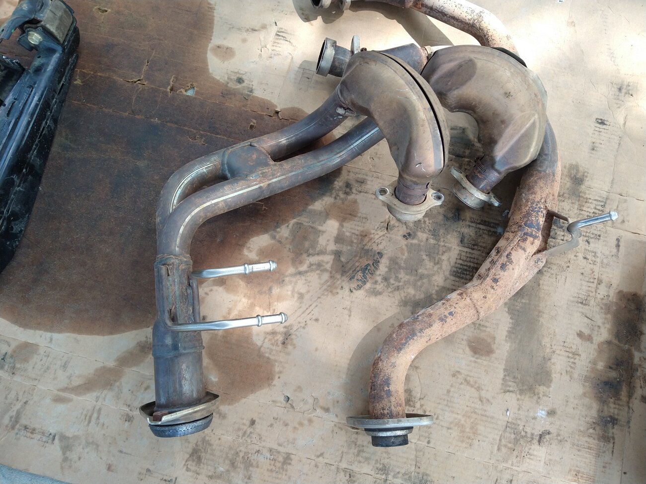

Not much the limiting factors are your air box and exhaust.
I have a complete Talon engine including PCM in my Pioneer everything but the exhaust and air box.
The performance gain was the same as my modded Pioneer engine I put the Talon engine in because my Pioneer motor spun a bearing.
My recommendation are.
1 put a good tune in and be happy contact Snuff
2 good tune, and a stock Talon cam and be happy
3 Tune, Talon throttle body, Talon or other cam, muffler, and 2023 Pioneer high range gear in the sub transmission.

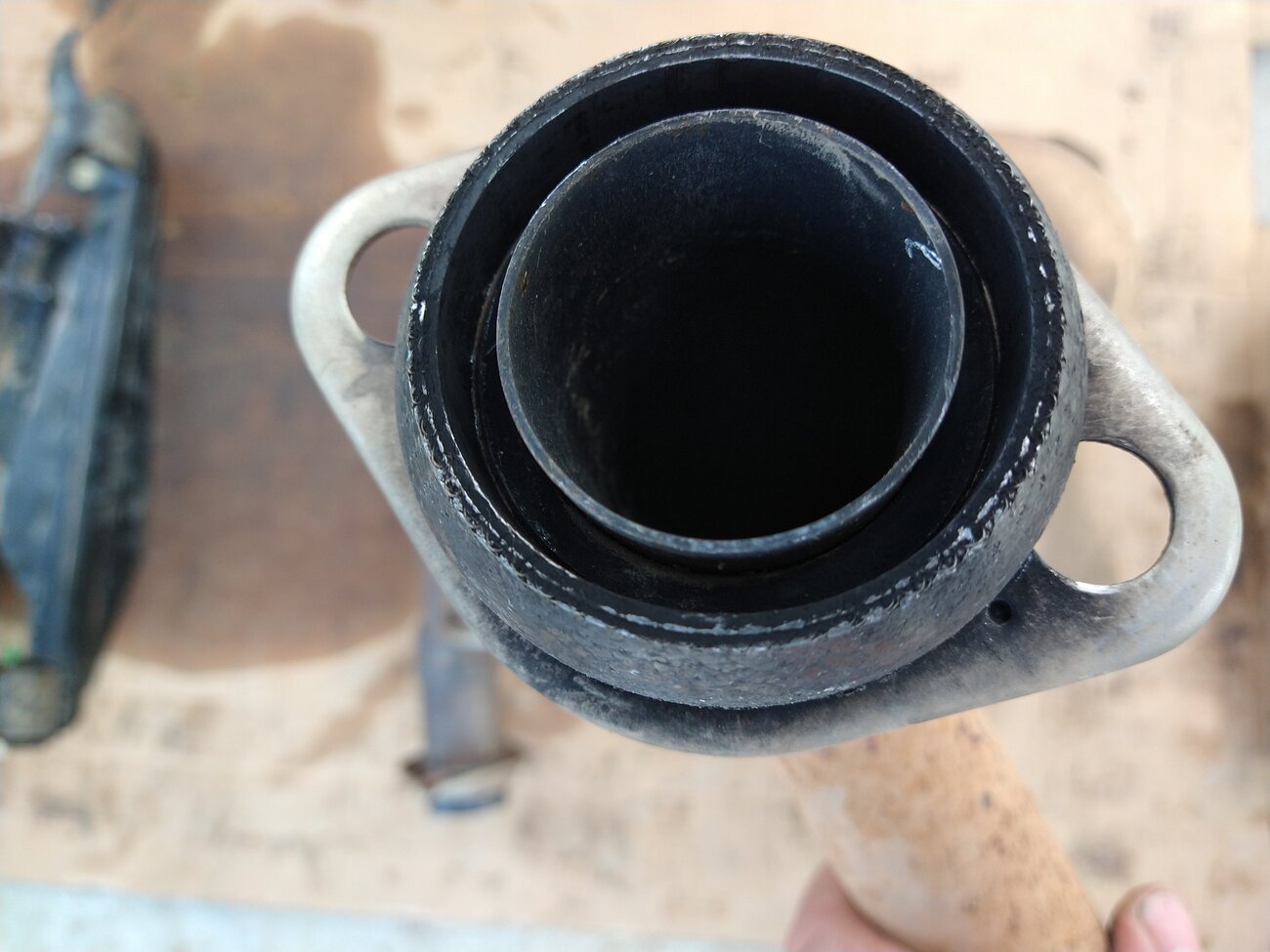

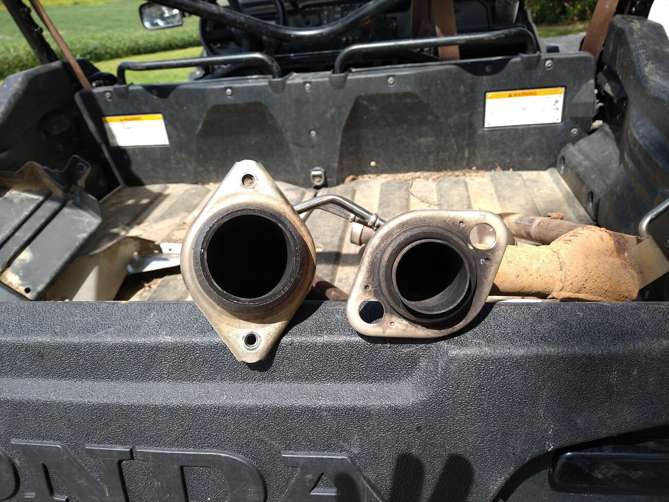

The attached photos are the Pioneer vs Talon header the last picture is the Talon exhaust donut slid over the Pioneer header.
I am not aware of anyone making a upgraded Pioneer header.

Thanks for the update! I have a guy local who has modded a full talon stage 5 trinity exhuast on his pioneer with a x pipe configuration. That still doesn’t solve the small exhuast port issue on the pioneer head. I would like to know more about you putting a talon motor in your pioneer im all for that. I have a 2023 6 seater
For the most part the Talon engine is plug and play, the engine has a extra dowel pin in the case so the Pioneer sub transmission will not bolt up, I removed the dowel pin and put plenty of silicone in the hole and it is working fine the Pioneer never had one anyway,
The other thing is you need to tune your Pioneer PCM and you are good to go, everything else bolt's together.
On Your 23 you already got the gearing and they changed the cam in 22 so I don't know what they done so the cam may not be needed?
I didn't pull the head off the Talon engine and pop the valves out for a deep exam, but from the out side they visually look the same.
With out a bigger head pipe porting and bigger valves is kind of a mute point it will flow more air but never live up to it's full potential.
