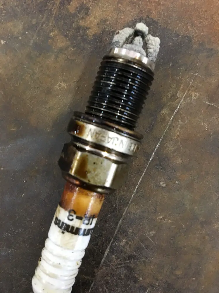

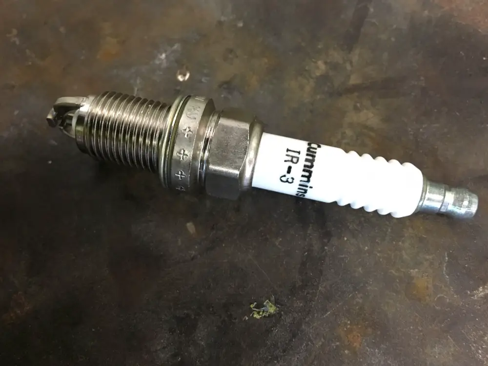

A Cummins with plugs..... Do you run jet fuel in it?
They make em, I change the plugs in them all the time 8edc5d2a40bb8f8c473ec078af8f849a
That’s what they look like going in
Fe7bf90d32f4def364bcb741ab3992f7
This is what they look like coming out
Reactions: CumminsPusher

They make em, I change the plugs in them all the timeView attachment 81320
Just looked at the plugs on Amazon. Pricey little devils. Is this a CNG engine? That would explain why it uses spark plugs. I tend to get a little riled when they over engineer things and charge 4 times what they are worth. This looks suspiciously like that.
