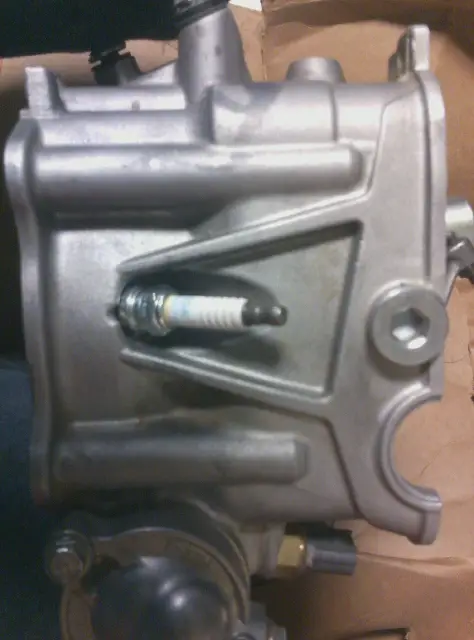

IMO I don't think you would feel any difference by adding the extra plug. More than likely there to help emissions. But you never know, put it on a chassis dyno before and after to see what it does, btw record the afr's on both pulls too.

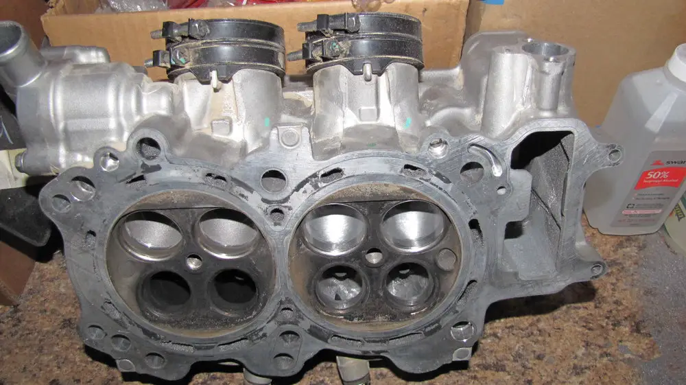

The rough work done on one cylinder.

Awesome. Do you have any more photos of the stock ports? Have u thought about ordering a African Twin cam and see if there's a difference? While you got it apart can you measure the base circle and lift of the cam on intake and exhaust?

Another thing is the Africa Twin is very light compared to our machines, so I'd be willing to guess the cam profile is way different and probably wouldn't work well in the p1k. If I were doing the head on my rig I'd probably just clean up the casting, make sure the intakes were port matched and smooth the bowls. Pretty much try to pick up the mid lift numbers and not worry about max flow at higher lift.
All I intended to do when I started was to clean up the casting. LOL
BUT there was this little lip by the exhaust seat that looked restrictive and before I new it, it was GONE!:D
If you look real close at the first up right picture of the four ports you can see the lip on the exhaust port I am talking about I don't know if Honda put it there for a purpose or they where just sloppy other then that lip the ports look like they would flow good.

That's pretty common with an as cast port. The casting will be a little smaller and they machine for the valve seat. No problem blending that.

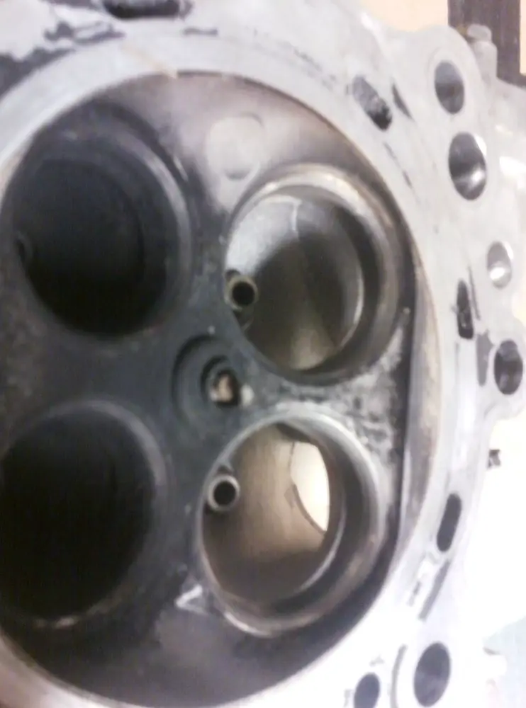

Wonder whats causing the different colors on the exhaust ports? Is one running hotter?
