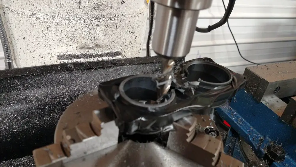

Honda advertises 44mm throttle bodies on the Pioneer but they have a 40mm restrictor in them here is a picture of the
pioneer sitting in the African Twin adapter it is a true 44mm intake
Untitled
GPR1500SC
GPR1500SC
Mar 3, 2016
861
2,426
North East MO
  2. Talon X LV
Africa is missing 2 bolt holes and is a little different but will bolt on. Don't know how well it will seal without those bolts...
I like the milling machine I wish for a small one to sit in my garage.
how did the plastic/rubber cut did it get smooth?
I figured a little silicone would do the job nicely as it set down over the cast lip.
