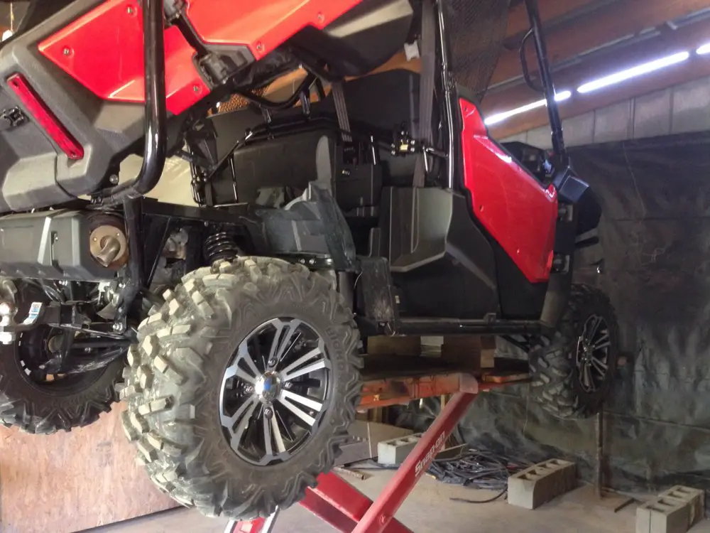

Had mine on the lift for the first service this weekend. Check it and there is no play at all. Got me to thinking if that is where some of my gear whine is coming from.
