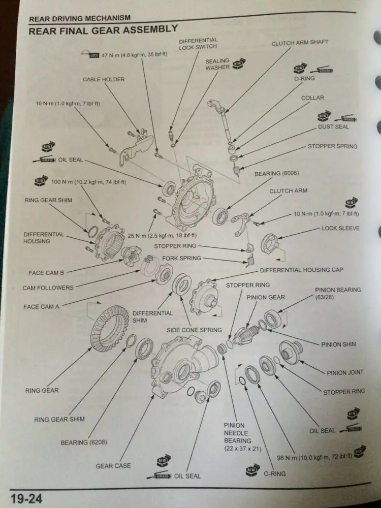

Here's a couple of pages from the manual. Hope it helps...
