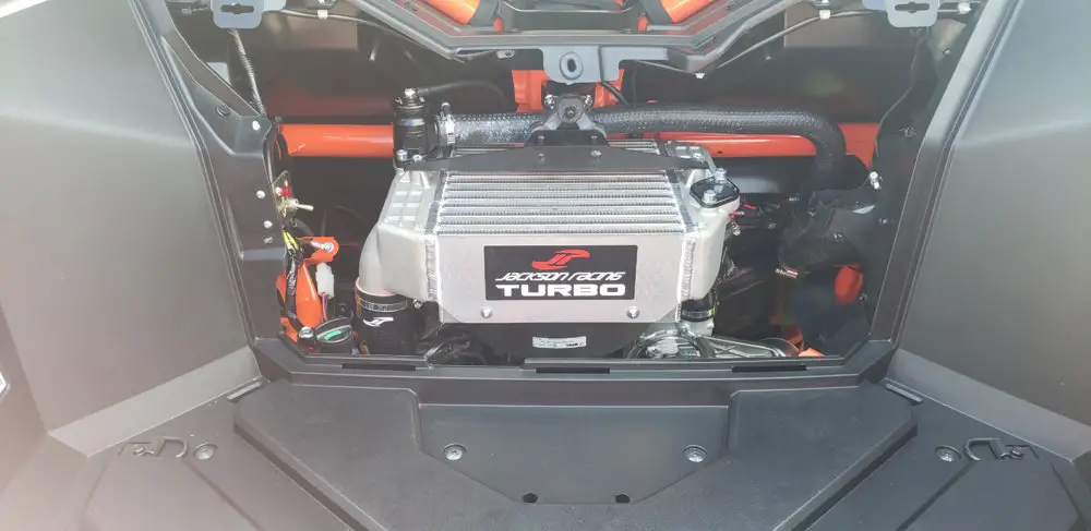

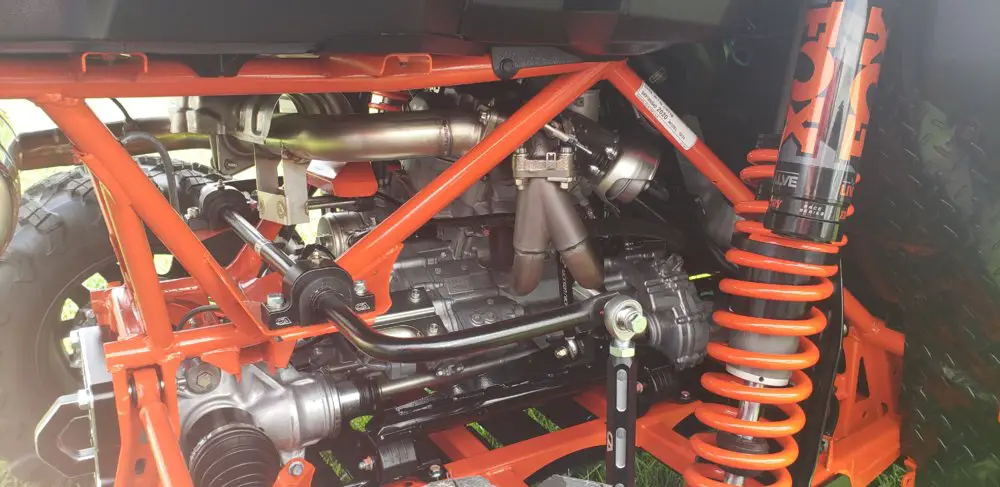

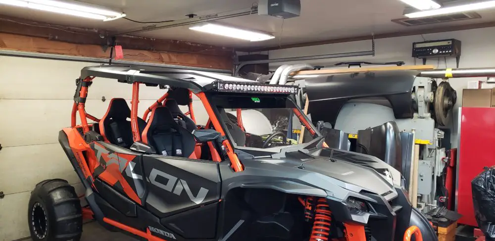

I got my 4 seat live valve kit over a week ago. It took me more then the 5 hrs others have mentioned but i was in no hurry. I have built several turbo headers and done a ton of custom turbo builds. I will say the components are very very nice. Cast Stainless collector! cast SS flange exiting the turbo! Fitment was spot on as well. It looks factory and Oscar Jackson is a great person to deal with. Now for how it ran remember this is in my 4 seater i weigh 209 and my son is around 140 we drag raced in the sand with 32" paddles against a RZR RS1 it "COULDN'T" run with this thing! Off the line it would jump out about a full length but i could drive right around it. From a roll i could run off and leave it. The RS1 had 30" paddles on it.
View attachment 198516 View attachment 198517 View attachment 198518
Wow sounds good. Was just about to order a particle seperator for my live valve but thought I’d ask about the filter that goes with the turbo. Sense the old filter area is now full of cool stuff where did they mount the air intake and filter? Also how much of a job is it to get it out to service? Thx
Its under the passenger side air vent. Its not as easy as the stock filter to get to but packaging is limited and i personally think they put it in the only place they could!
