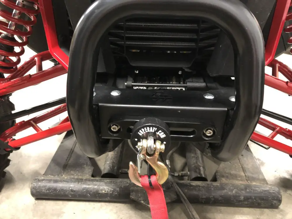

Added L&W Fab upper and lower billet radius rods (and did a little Mother's polish on them to give them some luster), L&W Fab winch mount, SATV 4500 lb winch from L&W, 30" whips from Booger Whips, and corner storage bags. I'll be adding L&W billet tie rods as well and then uploading some videos on their products as well for a more detailed look.
However, if you're considering anything that L&W is offering right now I would 110% recommend their stuff. The radius rods are beefy as all get out and really easy to install and the winch mount fitment really impressed me as well.

New video for the L&W Fab winch mount kit and SuperATV 4500 lb winch:
IMG 0366 IMG 0395
