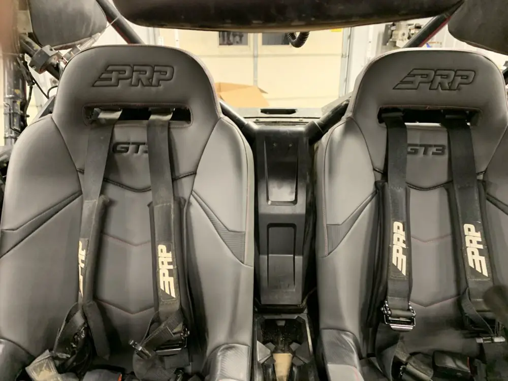

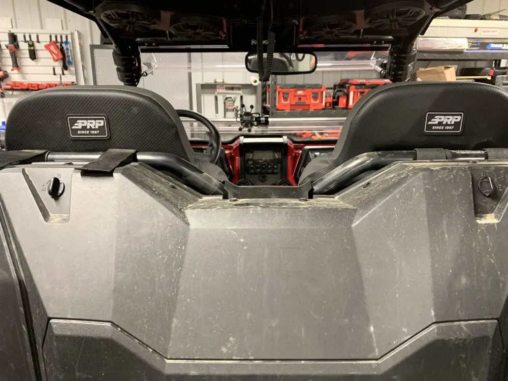

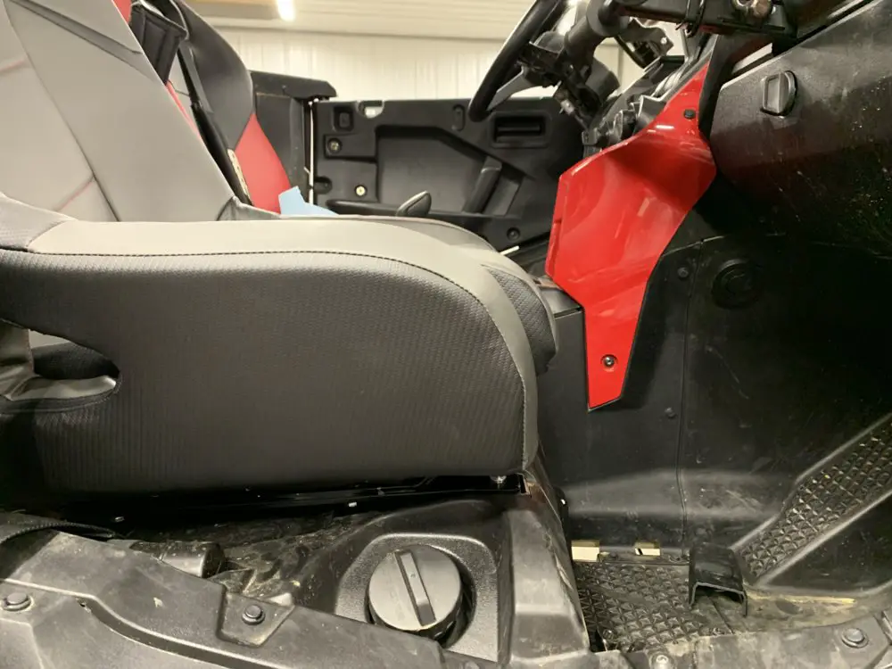

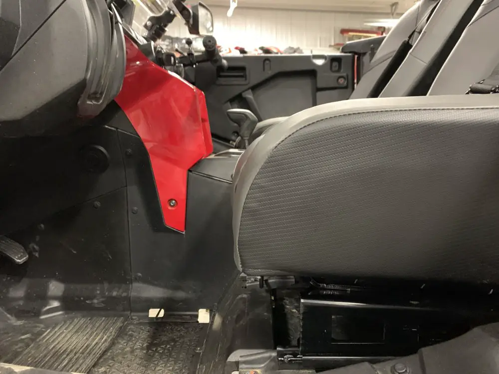

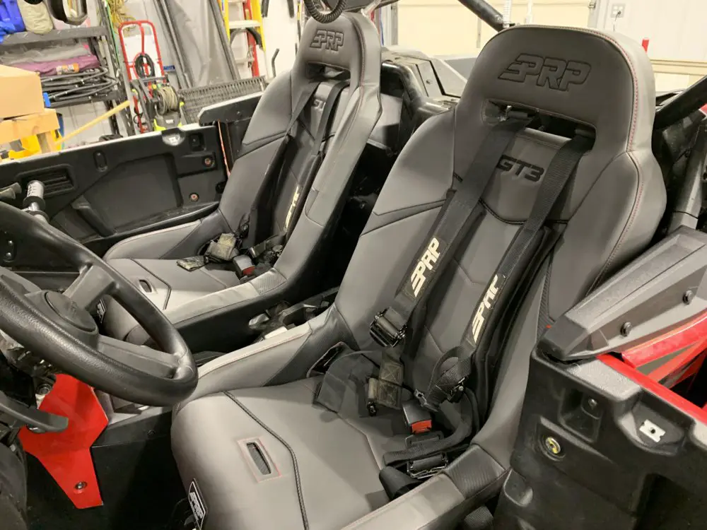

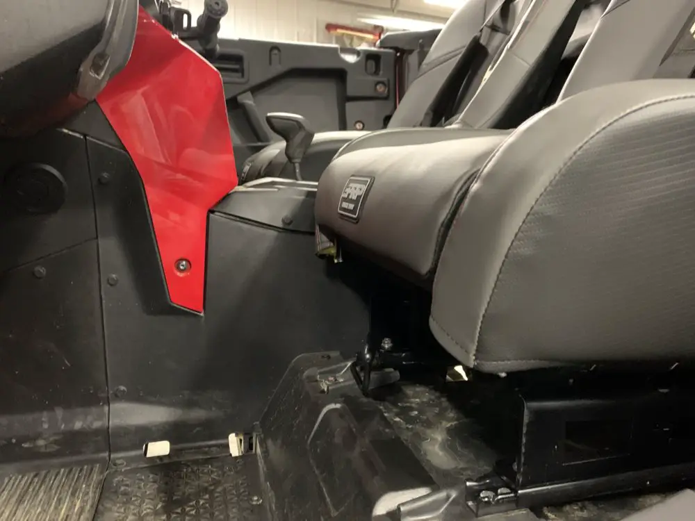

My PRP GT3 seats came in today. I got them installed with a very minor issue with the driver’s side brackets. Had to do a small amount of trimming, but nothing too serious and everything fits great after the minor trimming.
Update: Embedding video:
View attachment 152259 View attachment 152260 View attachment 152261 View attachment 152262 View attachment 152263 View attachment 152264 View attachment 152265
Great video. I’m 6’3” 230lbs with a 34” inseam. How’s leg room now? My biggest complaint with stock setup is my right knee hits the center console. I’m also concerned about raising the seating position when going with the aftermarket cage that would be shorter than the stock unit

Sounds like we’ve got a very similar frame except I’m 6’2”. They’re not going to increase your legroom, but the improvement in overall comfort is worth the trade off in my opinion.
You will sit higher, but do keep in mind that these seat bases have a ton of squish to them and you’ll sit “into” the seat a lot more than stock.
If the extra wide model would fit into the Talon I would’ve gone with them. If you like a little wiggle room on the side leg bolsters you may want to opt for the GT/SE’s.

I’ve been extra interested in doing a suspension seat in my X, so when I saw you post I was very excited. I ran out and used your pics for reference to my stock seats. It’s really looks like it lifts the fronts of the seat a lot. Looking forward to hearing your input after getting some serious seat time on yours. I’m only 5’10” so leg room and head height is as big of a deal. But still looks like you are raised a decent 1.5”
