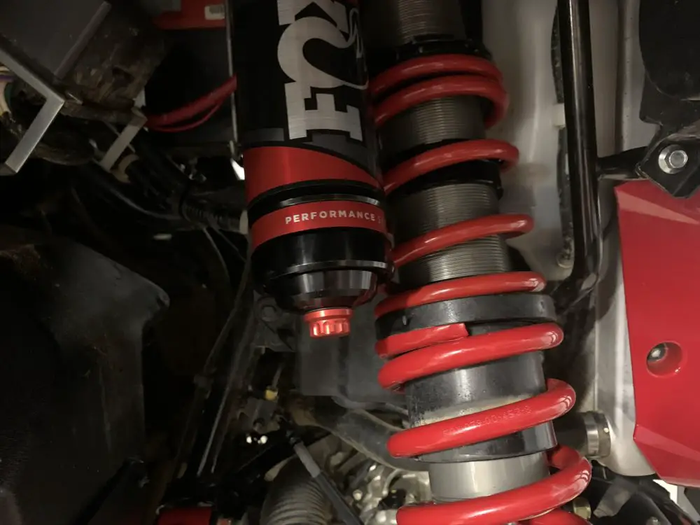

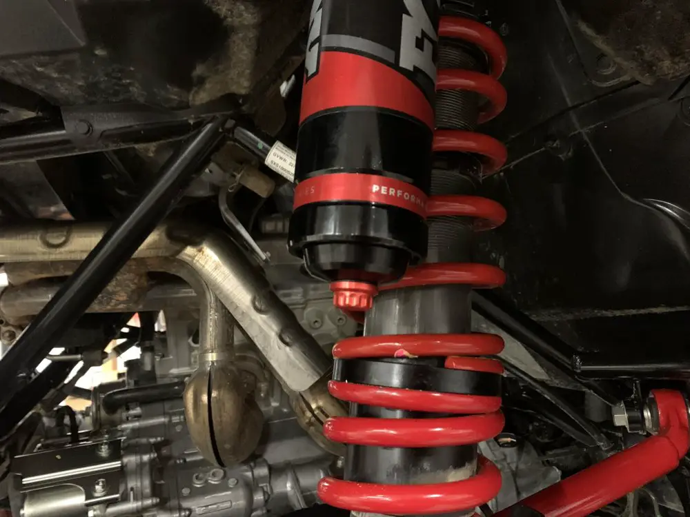

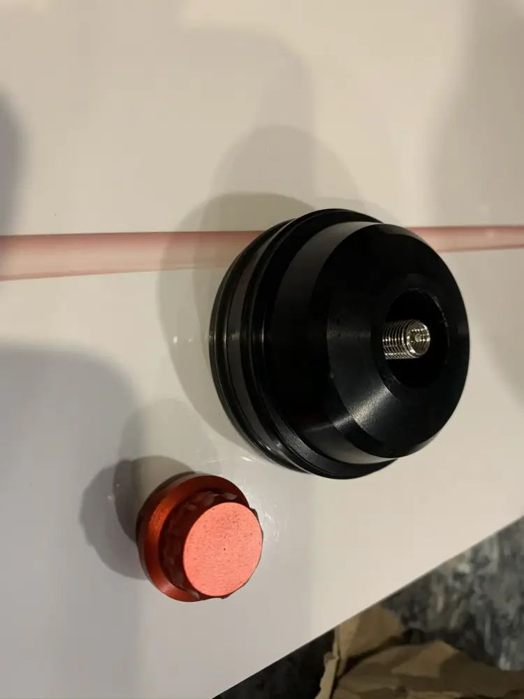

Last week I upgraded the factory Fox shock reservoir caps to some JC Racing caps with recessed Schrader valves. I bought the nitrogen recharging tools from Schmidty Racing Suspensions so I could refill the shocks with nitrogen and got a 20 cubic foot bottle of nitrogen from a local welding supply shop.
The one thing I had to make a parts store run for was a Schrader valve extension. The SRS tool has a no-loss chuck, but required the use of a Schrader valve extension since the JC Racing caps are recessed. I bought a 4-pack of Slime brand extensions, but they do sell a nice brass extension on their site. I'll include links to everything below:
JC Racing Fox Shock Reservoir End Caps with Recessed Schrader Valves (Talon R = 2.5" caps all around)
Schmidty Racing Suspensions Nitrogen Fill Tool
Schmidty Racing Suspensions Schrader Valve Extension (must have with recessed Schrader valves to be able to thread the no-loss chuck on)
Valve Stem Tool (I already had this tool, but it was used to thread onto the recessed valve and pull the cap back out to reseat it after installing the cap and installing the retaining clip)
The install is very simple and straight forward. I didn't bother measuring the PSI in each shock with a needle, but as I listened to the nitrogen release from each shock after drilling the holes it didn't sound like much was in them. Again, I can't quantify the PSI measurements for the stock setup, but 200 PSI is what they have now and I've got the ability to maintain them going forward.
I've got a video I'll be editing soon and I'll edit this post to include it here.

The JC Racing caps are the deal for sure. Still can't figure out why Fox will not address this issue instead of continuing to send them out knowing there is a major problem.
It is not a Fox issue, it is a Honda issue, Fox built the shocks to Honda specs. The entire machine, including the shocks, is under warranty by Honda. Fox has no obligation to the Talon customer, only to Honda. It is the same for any sourced out part on the machine.
Fox will do nothing until Honda tells them to and Honda will do nothing until "we" the customer complain enough. We need to stop blaming/hounding Fox and let Honda know our displeasure with their choice/design of Fox parts installed on the machine.

@TerryH agree on the JC caps. I was debating between the JC caps and the SRS caps and ultimately liked the aesthetics of the JC caps plus the recessed valves being more protected by an aluminum cap.
@PaulF I'd say you're correct. I'm sure Fox would love to sell thousands of their premium units, but they do spec to Honda's design/budget so we'd have to start with Honda on getting things corrected.
I don't disagree. It is at it's root, a Honda issue. Honda certainly could have and probably should have specified a different shock system or shock vendor. The fact remains that Fox has made the 2.0 and 2.5 shocks with this fill system for years and they well know by now that there is an inherent problem with them but have done nothing to rectify it.
