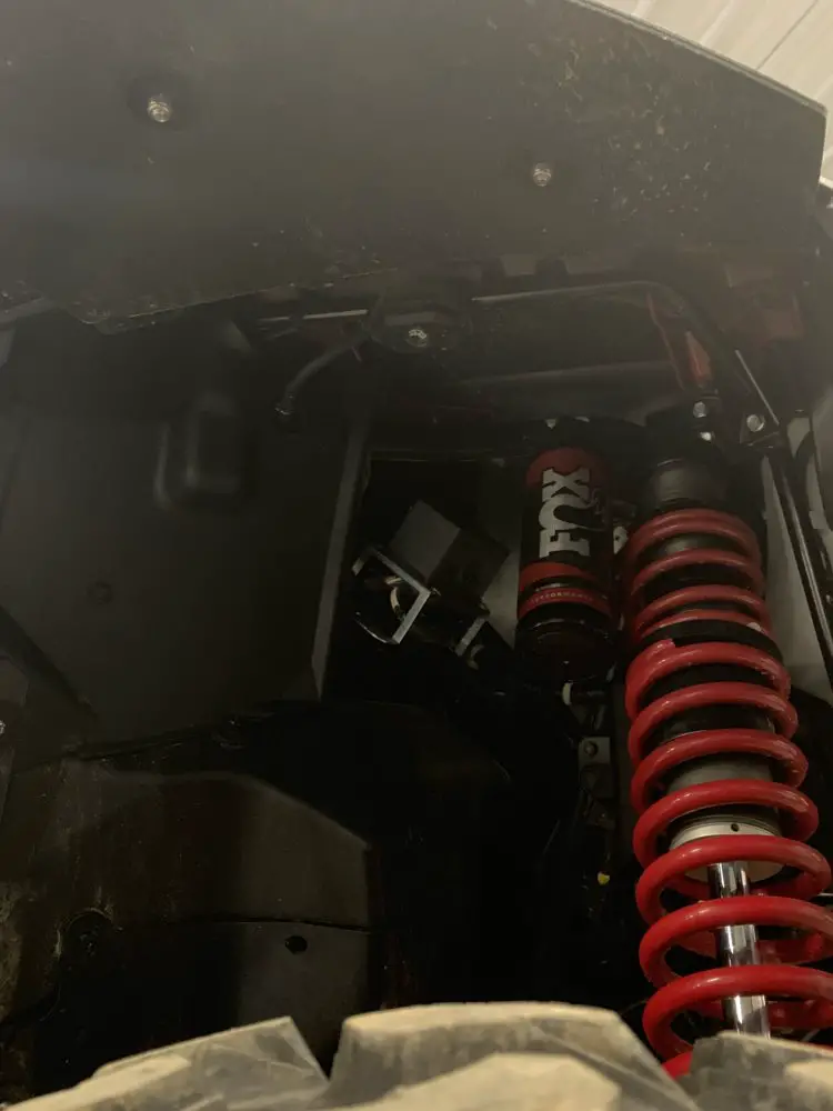

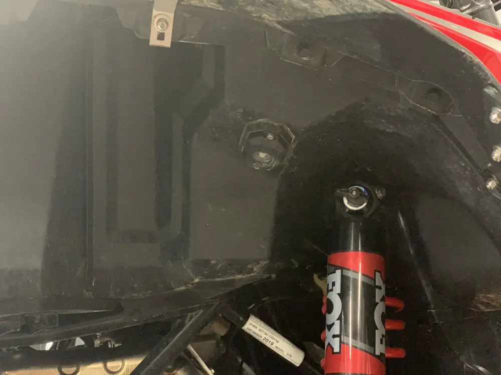

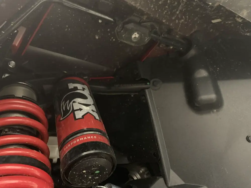

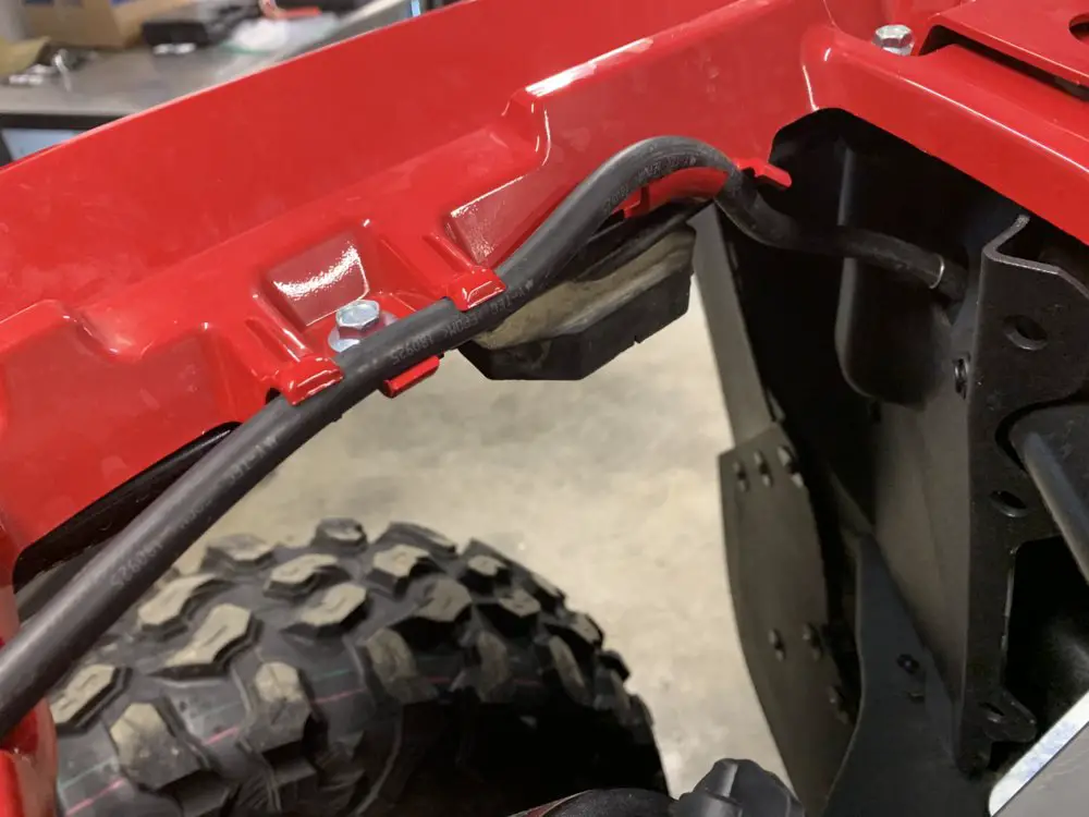

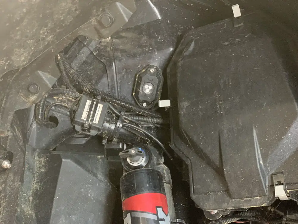

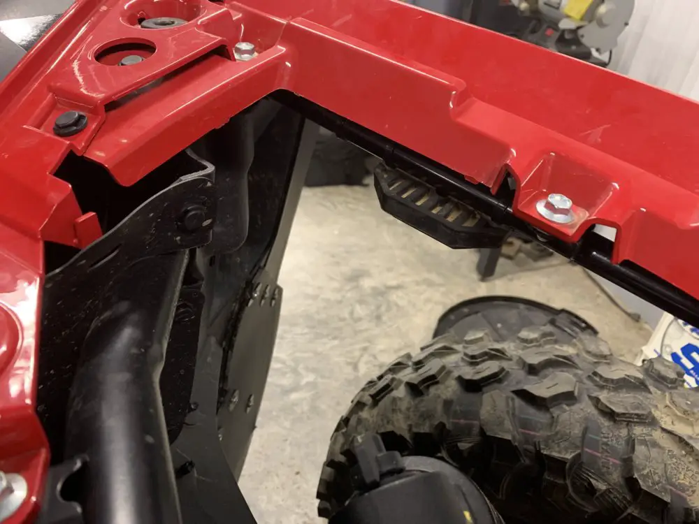

Do you have any pictures of where you mounted your rock lights?
jasond
jasond
Mar 15, 2019
221
352
Indiana
I just took a few for you:
The rear passenger side required the most work, but it's not difficult by any means. I removed the inner plastic fender well from the machine and drilled some holes to locate the rock light before fastening it to the plastic with nuts and bolts. Just remove the plastic push pins/rivets and it should come right out. I don't recall off the top of my head if there are any bolts that hold it on, but if there are it's maybe 2-3.
The driver's side rear light is also fastened using nuts/bolts and the bolts run through the firewall that separates the cab from the engine bay. You can also see the control module zip-tied to the frame beside the driver's side rear light.
The front lights are very simple; I just zip-tied those to the metal tubing that supports the front fenders and ran the wires through the center console back toward the control module.

Hope this helps. My YouTube channel link below has several videos as well if you need to use those for other accessory ideas.
