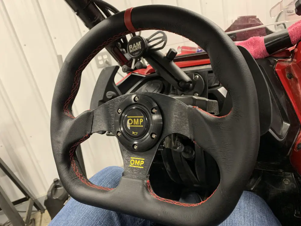

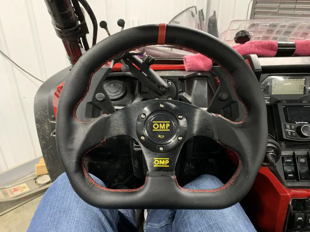

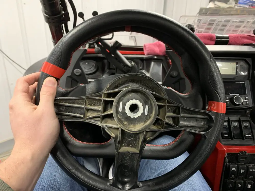

EDIT - changed the steering wheel adapter/hub over to an Assault Industries adapter. The cheap eBay option worked, but developed some play and was driving me nuts.
Changed my steering wheel out to a Chinese clone of an OMP steering wheel. For $58 bucks (they accepted my eBay offer after a bit of haggling) this wheel is incredibly nice and I may upgrade to a Hess Motorsports quick disconnect like @TerryH used in the future.
I did have to cut the wheel adapter down on the "neck" of the adapter to bring the wheel closer to the shift paddles, but it was a 2 minute process with my portable band saw. I also removed the black plastic cover/shroud that was on it.
Link to Steering Wheel: 320mm Leather Superqua Flat Steering Wheel For OMP MOMO Hub Red Stit Red Stripe | eBay
Link to Adapter: Assault Industries Steering Wheel Hub

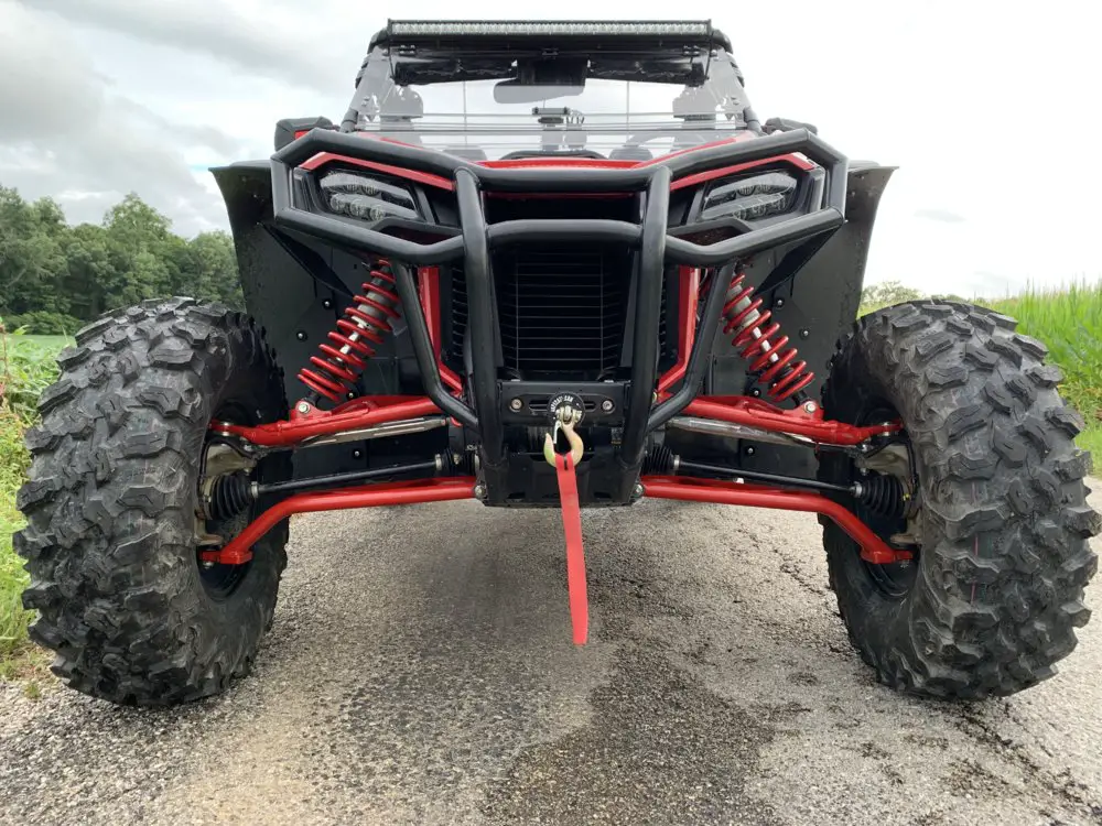

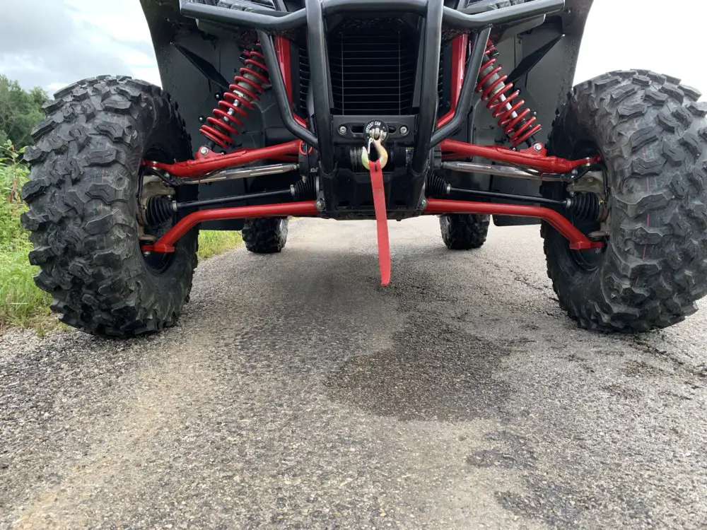

I’ve been busy here lately, but finally got some shop time this week and got around to a few things. Finished installing the L&W Fab high clearance a-arms this evening. They definitely squeezed every bit of clearance they could get out of these a-arms and I’m very pleased with the fitment. I double and triple-checked that the axles don't rub the a-arms while it was up on my lift and they do not rub.
NOTE - I ordered these in a raw finish and had a local powder coating company do the powder coating since L&W isn’t currently offering red.
If you’re going to do any sort of a-arm modifications do yourself a favor and invest in a ball joint separator. These ball joints are crazy in how much it takes to remove them from the a-arms. Just get the right tool for the job for $20 at Harbor Freight and save yourself a headache and beating with a hammer.

How do you like the L&W a arms? Did you notice any difference in the handling or suspension? I like the clearance and heard they are about 7lbs heavier per side than the stock a arms. I’ve damaged 2 of the factory a arms already and recently went to 32’s, They help with the clearance but could always use more. Appreciate your videos, I’ve watched several as I’m doing my own upgrades and they have been very helpful.
Reactions: jasond
I can’t say enough good about them and I haven’t noticed any difference in handling or steering.
Just make sure and use a ball joint separator if you don’t already have one. It makes the job exponentially easier to do when replacing them.
Link to Adapter: Prelude 92-96/Accord 90-97 Jdm Hub Adapter Kit Fit 6-Hole Steering Wheel Black | eBay
