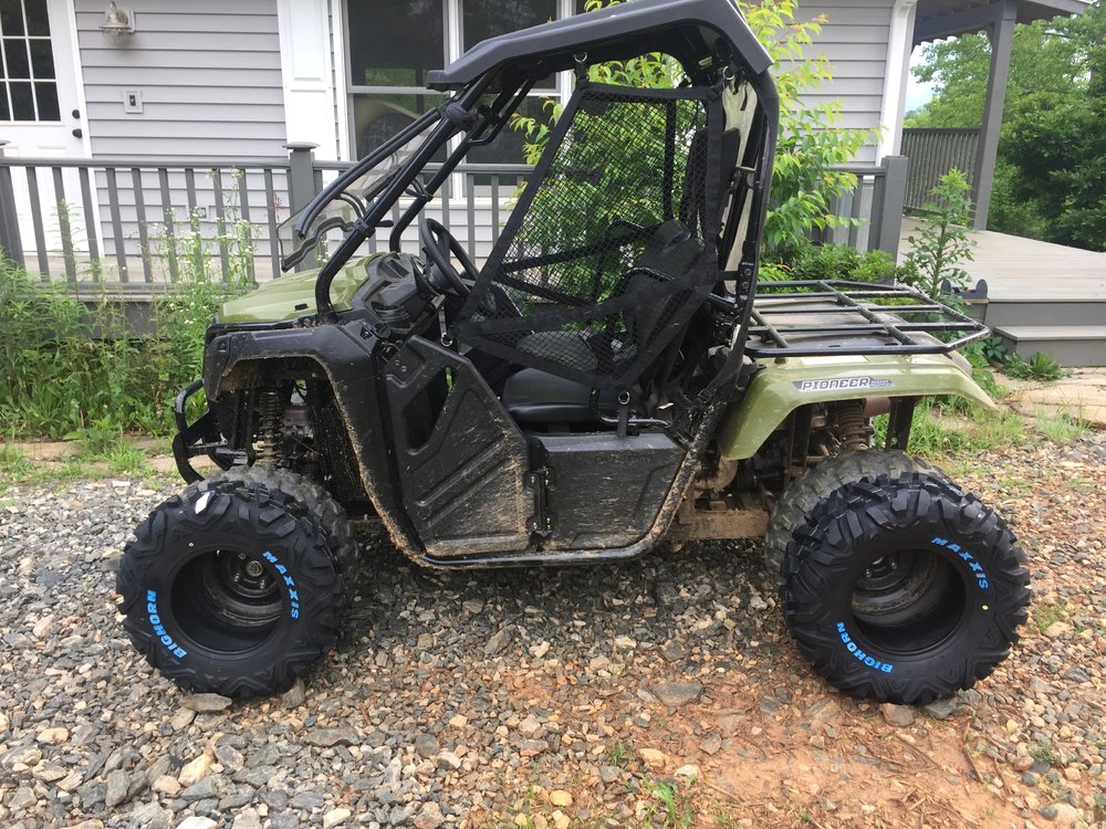

My 25" X 8 &10 X 12's Maxxis BigHorns arrived today so I put them up alongside the stock tires for comparison. There is no comparison. Thinking a Double Dually would be cool looking though! Gonna have them mounted at local tire shop and I'll fill them with quad boss myself.
View attachment 45327 View attachment 45328
BA Gnome! You won't be disappointed with those.
There was a guy back in the day that posted a pic that looked like he had done the dually's but it was BS! He was on for like two days and then never saw him again.
