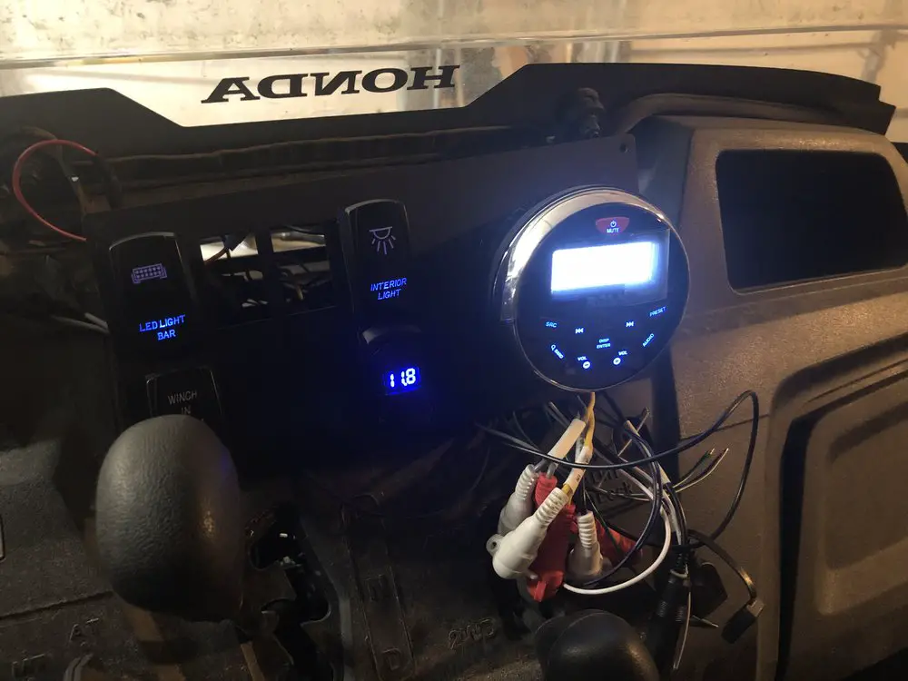

Started into the build yesterday. Mainly just cutting the dash and installing a Mystic switch panel plate. I can't speak for any other panels out there but if Mystic's are awesome. Even considers the bar behind and locates accordingly.

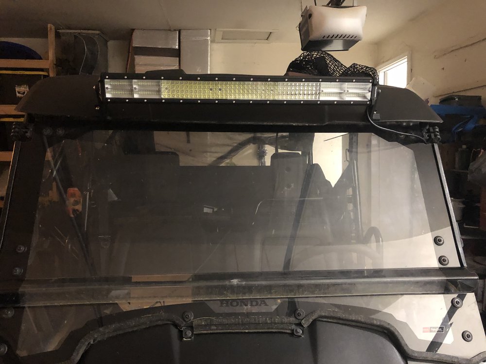

I did run into a problem that I can't sort out. I bought the Autofeel 29" LED Bar. It has dual lights white and amber. The bar has three wires coming out, red, black, and white. Red is going to battery, Black is going to ground and white is going to the switch. I'm using a 5 pin rocker switch to turn it on and off, at least that was the plan. When I turn on the machine the light turns on no matter what position the rocker is in. They do sell a separate wiring harness with a remote control that has the lights do all kinds of different flashing and modes but I just want it to simply turn on and off.
Light Bar

Got it figured out. So black and white are both grounds and red is power. You can hook up a SPDT running the two ground wires to it and light up white or amber independently. Since I have a SPST switch in running white and black both to ground and red to switch. I think after being at it all day yesterday my brain was a little fried.

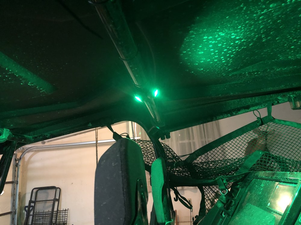

IntLights
Switch Plate
Light Bar
So far so good, taking my time to make sure it's done right so it going a little slower than I hoped but happy so far. Thanks for everyones tips on this site.
