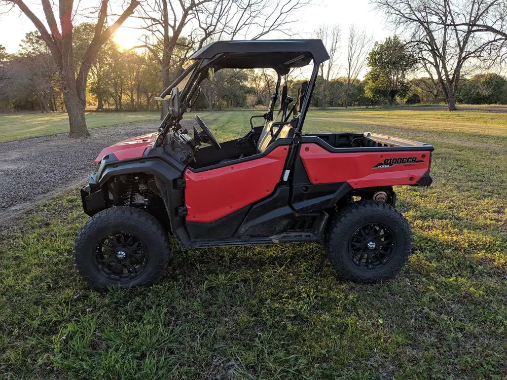

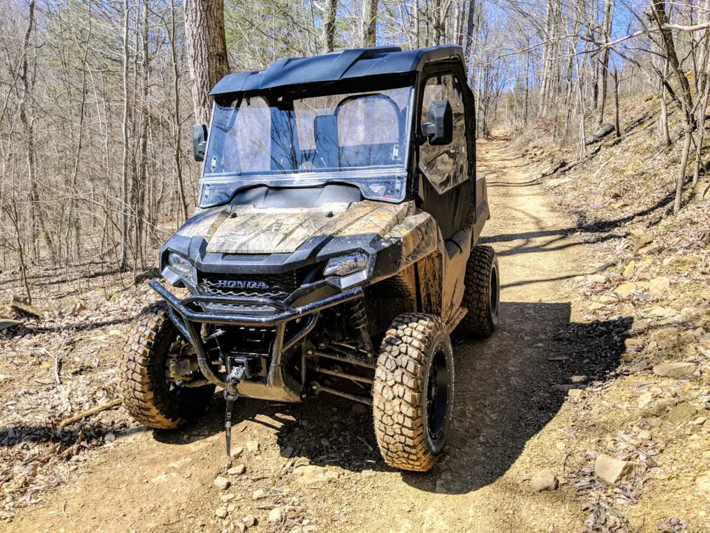

Thanks everyone who provided information on the light truck tires. I ordered these Qaudboss Scoville Boss wheels, 15x7 5+2 4/137, for $34 each shipped! It looks like these are on closeout at many retailers; eBay, Amazon, and various power sports shops.
https://www.amazon.com/QuadBoss-Scoville-Boss-Wheel-RT-GW17A157137DBB/dp/B017OF96G2?tag=sxsweb24-20
Quadboss Scoville Boss 15x7 Matte Black Wheels - Just For Fun Honda

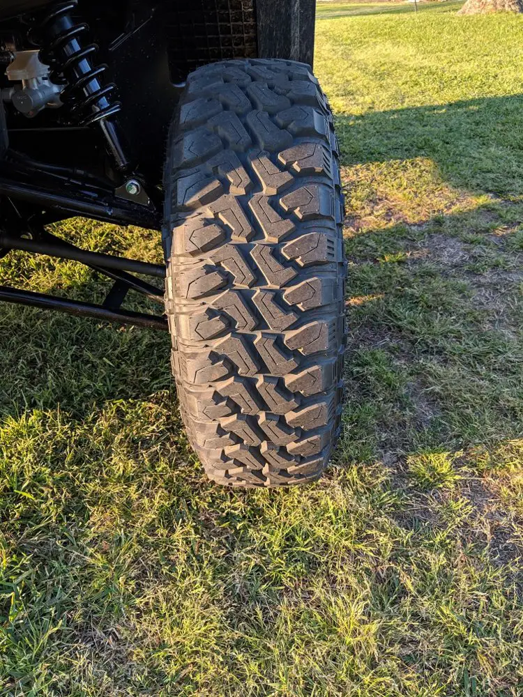

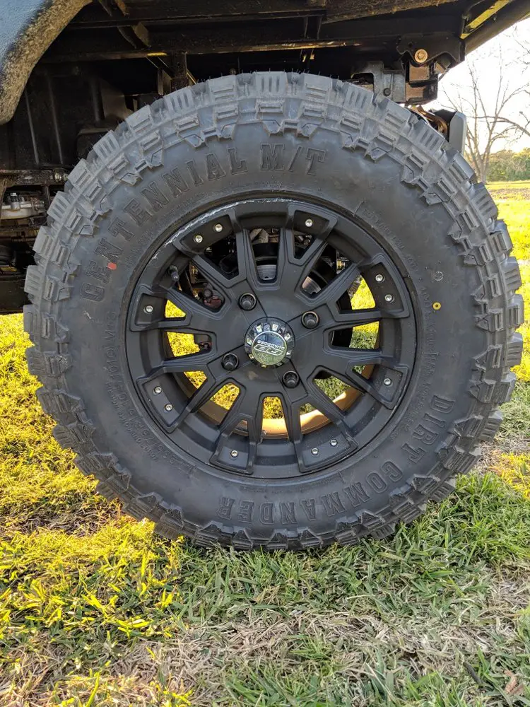

I looked at different tires and settled on these Centennial Dirt Commander M/T in 235/75R15. I liked the look of the tread and the aggressive sidewall. Looking up the DOT number on the tires says they are made by Dunlop in India. I found those for $380 shipped on SimpleTire with a coupon they offer for new orders.
$108.97 - Centennial Dirt Commander M/T LT235/75R-15 tires | Buy Centennial Dirt Commander M/T tires at SimpleTire
I used High Lifter 1" wheel spacers on the rears. I mainly picked them because it was tough to find spacers with M12x1.5 studs and they advertised using grade 8 studs. SuperATV wheel spacers also use the M12x1.5 studs, but it was not in the product listing and I already ordered the High Lifter by the time they replied to my email.
IMG 20190320 190441 2 Tire Tread

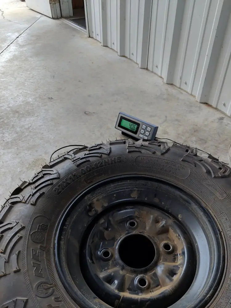

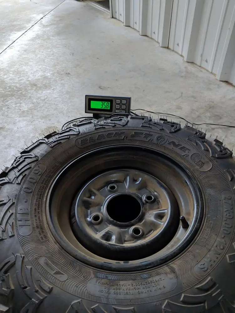

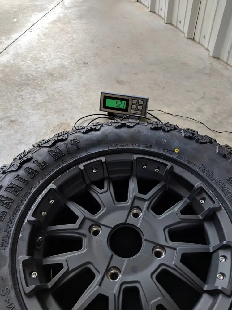

If anyone is interested I weighed the stock front and rear wheels and tires and my new wheels and tires. The stock front is 36 lbs, stock rear is 40 lbs, and my new wheels and tires are 52 lbs. Centennial's website states the tire should weight 40 lbs. I did not weight the tires before mounting.
Stock Rear Stock Front IMG 20190315 184416
Overall I'm very pleased with the way the new tires handle and ride and the way the wheels dressed up the Pioneer from the stock wheels. The tires are very smooth and quiet on hard surfaces. The new tires handle much better and are more predictable than stock. I didn't realize how loud the stock tires are on pavement. The new tires are also less prone to track or wander in ruts or well worn tracks. The new tires are stiffer, but in a good way that makes the Pioneer feel more planted and stable. There is some slight power loss; most noticeable when starting off in high gear. The engine braking is slower to stop it from speed, but I think it makes the Pioneer less jerky. I definitely have to use the brake pedal more, but not excessively.
Mounted, the Centennials measured right at 29 inches laying on the ground before installing. The tires had 45 psi from the tire shop. After installing I aired them down to 11 psi. I tried that for a day but felt a little mushy. I went to 14 psi and that was definitely too stiff. I ended up at 12-12.5 psi but may play around with it some more.
After letting the tires settle at 11 or 12 psi they measure 28 inches or a little less. Mine do not rub unless I'm at full lock and the wheel articulates over a large bump or something. Even then its minor.
I did have to adjust the steering rods to get the wheels aligned. I used a 2x4 to align the fronts to the rears. Not especially scientific but it appears to work based on driving feel and looking at wear on the treads.
I looked at different tires and settled on these Centennial Dirt Commander M/T in 235/75R15. I liked the look of the tread and looking up the DOT number on the tires says they are made by Dunlop in India. I found those for $380 shipped on SimpleTire with a coupon they offer for new orders.
I used High Lifter 1" wheel spacers. I mainly picked them because it was tough to find spacers with M12x1.5 studs and they advertised using grade 8 studs. SuperATV wheel spacers also use the M12x1.5 studs, but it was not in the product listing and I already ordered the High Lifter by the time they replied to my email.
View attachment 116427 View attachment 116428 View attachment 116429
View attachment 116431 View attachment 116432 View attachment 116433
