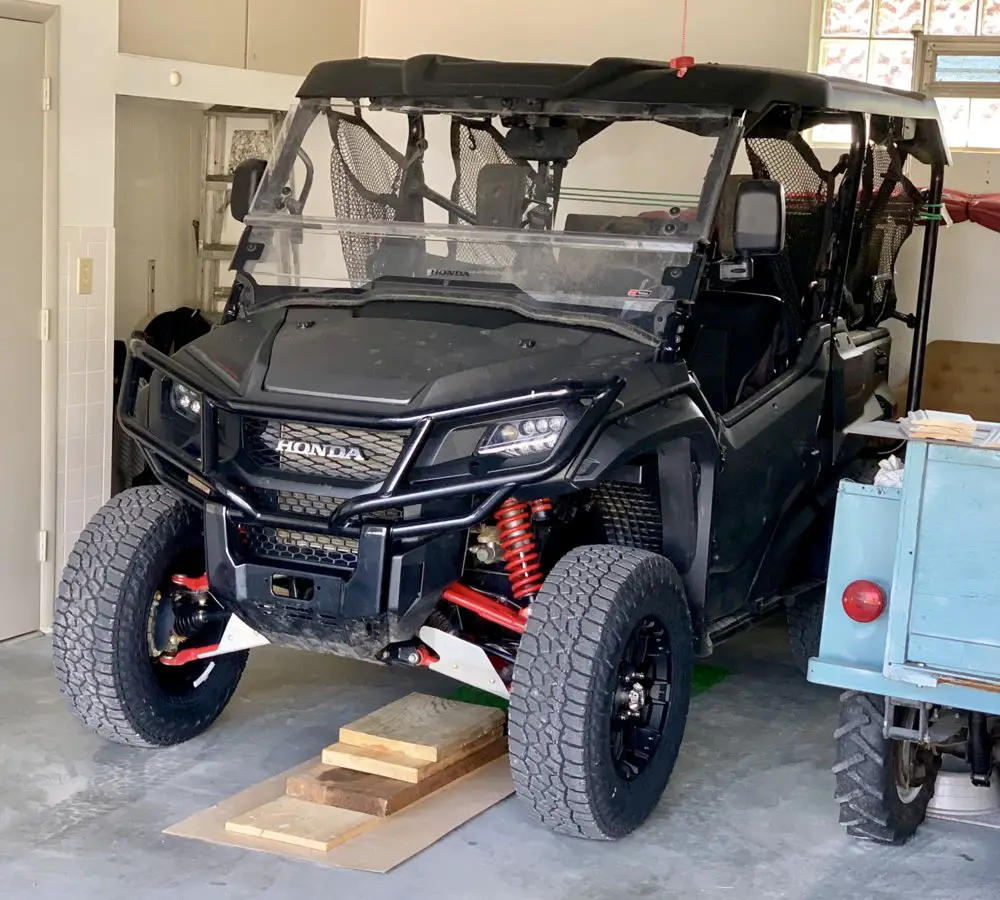

Alright guys, got them on this weekend. Didn't get to do a ton of driving but did get a chance to take them down the road. First impressions are as follows :
-Road noise from tires was almost non-existent, which was a big change from the factory Maxxis Bighorns.
-As others have said, definitely took a little more brake to stop, but did not seem excessive.
-Overall I did not feel a large change in power although it did seem noticeable that the wheels and tires were heavier.
-Ride seemed smoother all-together although I did notice I was able to feel the speed bumps on the road I was driving on a little more.
For now tires are set at 14psi- may go to 12 but wanted to do a little more driving first. Tires were close to 29" tall initially, but after deflating they settled down closer to 28". Going to do my best to measure toe and camber and adjust if necessary at a later date.
*Side note: I've looked around the forum and haven't had much luck finding a tutorial for adjusting toe and camber- could anyone help me out there?
View attachment 119408 View attachment 119409 View attachment 119410 View attachment 119411

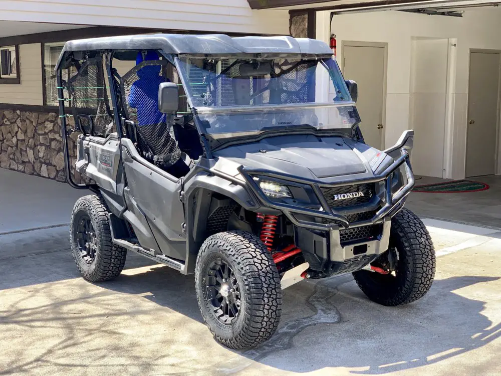

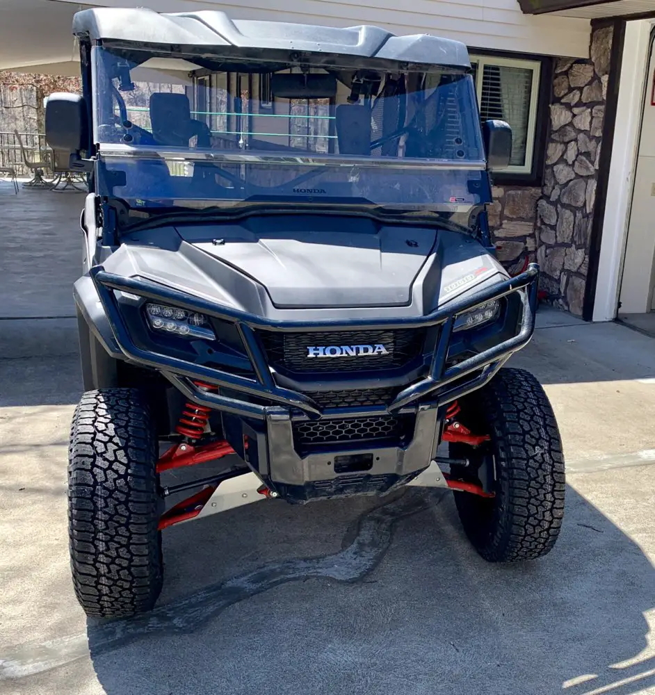

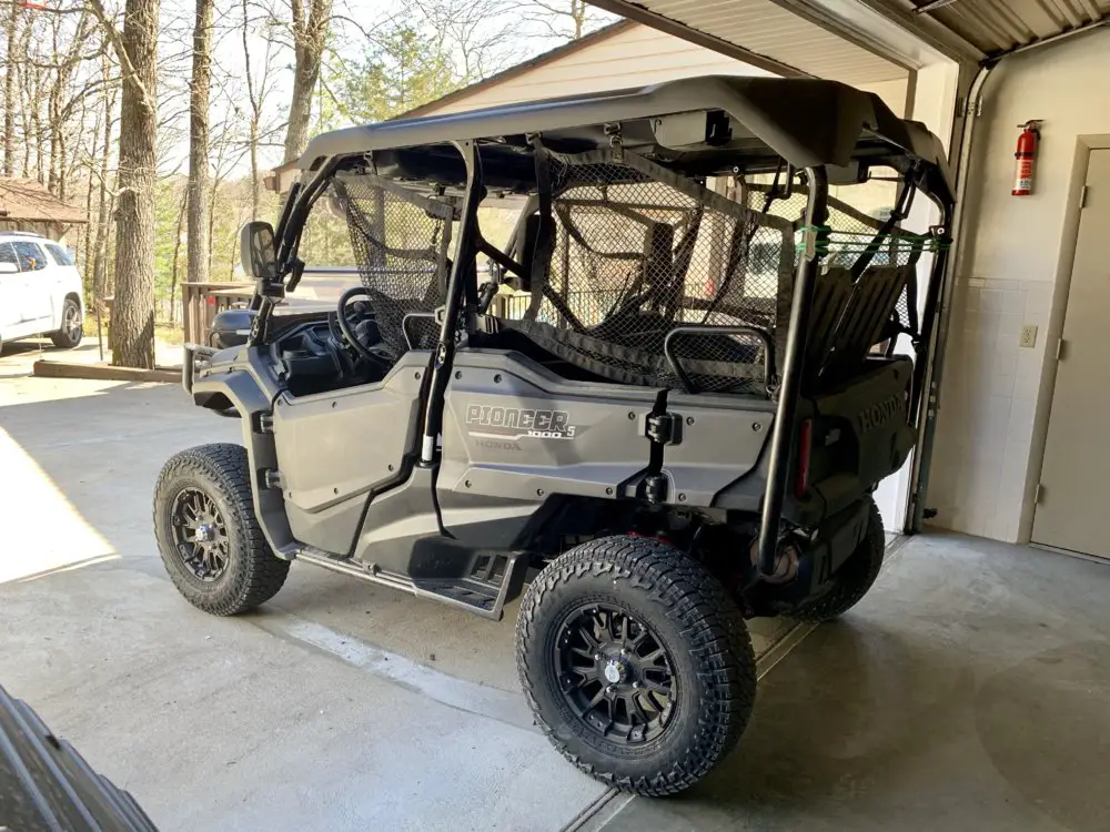

I'm guessing you ordered the 15x7 rims? If so you can run the 235/75r15 tires. That tire translates to a 29x9 on a truck or aired down for our buggies about 28x9 depending on air pressure. This is the most widely available 15 inch tire size. It's also the largest you can run without a lift. You should be able to find several options in mud terrain or all terrain. There is also the 215/75r15. It's about 27x8 on a truck or 26x8 on our buggies. You will likely only find that size in all terrain.
Honestly, I'm very pleased with my 235/75r15s. That size is more available and cheaper than the 215/75r15. Based on pictures posted on this forum, the 235/75r15 is probably what 95% of the guys running truck tires are using. I also wouldn't worry much about the brand of the tire. I would shop by price and looks (tread pattern and sidewall) in that order. Our buggies weigh a quarter of the weight these tires are made to carry, so they will perform beyond what we require. I almost ordered the discontinued, previous generation BFG Mud Terrains, but I just didn't think it was worth it. Same with the Maxxis DOT radials available. I was also trying to keep the total cost of wheels, tires, lugs, spacers, etc to $500ish.
I would stick with a mud terrain unless, like the other guy in this thread, you plan to run two sets of the wheels and tires. Like, get a set of pure ATV mud tires and set of all terrain truck tires for summer or something. The mud terrain is like an all terrain for our buggies.
I'm running 9psi in the front and 11psi in the rear.
