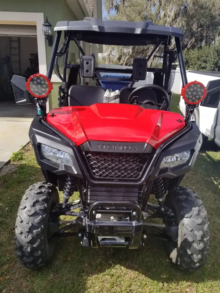

I have to admit that when I plowed snow last week, which was the first time I drove my P520 in the dark, I was shocked at how poor the stock headlights were. I had already installed a forward-facing light bar on the front lip of the Honda hard roof, and was very glad I did. The main reason I installed it was to make sure the plow wasn't blocking the all of the light. The plow could have been one of the reasons the headlights seemed so dim when I plowed. But based on the other night, I would consider a light bar a necessary upgrade on any P520 right from the start, regardless of whether or not you plow. I will probably install a small rear-facing floodlight light bar to help with backing up when plowing. It was very difficult to see through the rear Honda soft panel when backing up in the dark (it was also snowing hard, which might have contributed to the problem).

Seems like the most likely front end lighting options for those of us with the Strong Made bumper with winch is a roof mounted light bar and/or a small light bar/2 cubes mounted on the hoop.
Fabricating/integrated two cubes into the Strong Made would be ideal for my interests, personally. A roof mounted light bar would be good on occasion, but no good for anyone in front of you . . .

I am using the p520 for work on a property in the country. It does not hurt anyone where the light is mounted.

I've never considered the stockers as anything but running/marker lights really, they're just not bright enough. A light bar or cubes on the bumper act as the real headlights. Having lights at different heights is ideal.

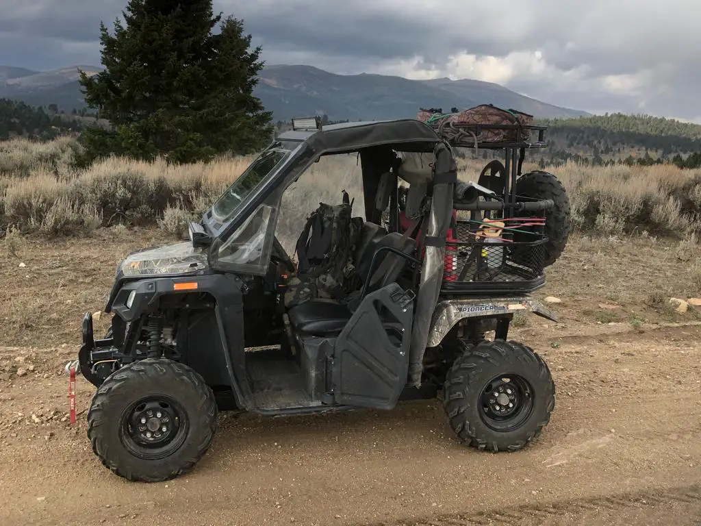

Both led bars are from amazon. I run a bead of silicon caulking around the glass/ metal edge and where the wires enter to help with water resistance.

Nice! Love the camo. Are those fold back side panels? If so do they work well for you?

Roof mounted lights would not for our P5, the trail just to tight. The light bar would take a beating on the roof. I mounted ours a little lower.
I agree tight trails would snag and beat up a roof mounted light bar where I ride. That swayed my decision to install lights lower and more centered.

Nice back rack. What size tires are you running?
It’s a Dusty Dawgs rack. I’ve posted several times how it’s great for our lab, and for carrying hunting gear. The top coincidentally is a perfect fit to hold my 2-bow compound soft case.
I bought a set of Rancher take off’s with rims for $400. They’re 25” and stock widths. I have 1” front and 1.5” rear spacers. I was able to get thru the 2 metal posts on a 50” ATV-only trail with no problem.
I like the look of your setup. Very nice rack and I been thinking 25" tires 1" rear spacer would work well for me. Thanks for the info.

No, Falcon Ridge soft doors. I roll them and secure with a bungie cord. They keep me much warmer with only engine heat which was was the idea.
Thanks for the info! I have been looking into doors for this time of year, to cut down the chill when using around a campground or for short trips. This look like they would fit the bill as I would like them out of the way during trail rides. I will look into them. Thanks again for sharing.
Actually a 12” light bar mounts nicely to the Strongmade and answers well to the lighting problem….👍
