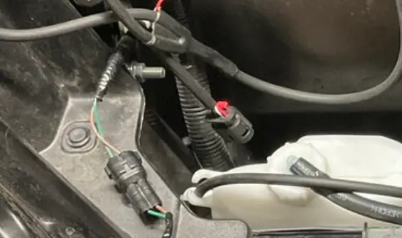

Does anyone know where I can get a couple of the Honda OEM plugs that are part of the headlight circuit? I figure it might just be easier to splice it in like that then to actually strip the wires back and tie everything together.
1659374667716
If I could get a male and female set, I could connect my PIAA light to this.
Rob
Rob
Take good pictures of each side and send them to @Hondasxs if anyone can help you, he can.

This one. Ours are now black.
Perfect! I will no doubt order a few sets so I can add more accessories
