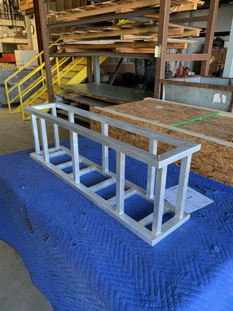

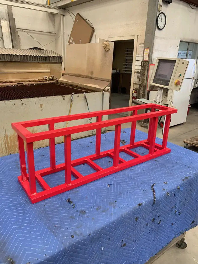

Off to the powder coat with it.

My next step now is to fabricate (from 1/8” steel) a direct receiver attachment (painted black) that this rack will carriage bolt to. Minimalist but ample support.

Make sure to angle it up a bit. Maybe even build or buy a hitch extension and t-off straight up?

I’m going to build it all because I want it light weight. 2x2 square tubing with 1/8” wall coming out of the receiver, cut at a 45 then turning straight up just clearing the trailer by a 1/2” or so vertical 12” with a 2x2 I/8” angle iron 2 foot long welded to the top, and the rack carriage bolted to that. With one of those u-bolt stabilizers on it coming out of the receiver.

That sounds solid!
