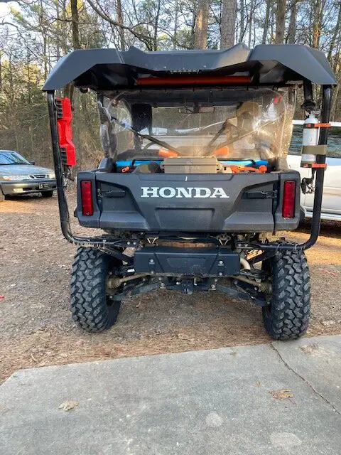

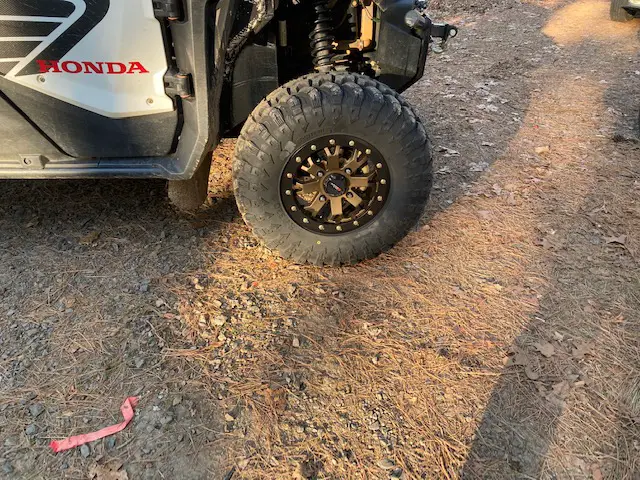

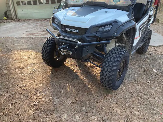

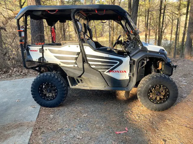

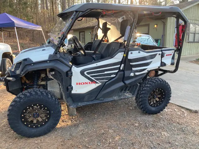

Baby Gets a New Pair of Shoes! Finally got the nerve to pull the trigger on a new set of wheels and tires for my Pioneer 1000-5. Went back and forth for months debating about size, style, offset and all the other issues that we worry about. About the only thing not in question was the "Bronze" color. Landed on the System 3 SB4 Beadlock wheels and System 3 RT320 DOT 8 ply radials. Same size all around but I did go with a 6+1 offset on front and 4+3 on the rear. These offsets gave me the identical width as the stock machine in front and just a little less than stock in the rear. Now the front and rear tracks are almost identical. I like the look of a single size tire all around. Drives well and is so smooth and quiet. I am probably going to sell my original DELUXE Wheels and BIGHORN 2 (6Ply) Tires and Wheels.
IMG 1571
IMG 1572 IMG 1570 IMG 1569 IMG 1568
View attachment 317475 View attachment 317477 View attachment 317478 View attachment 317479
Looks great. Shouldn't a 4+3 offset in the rear give you a wider stance than stock? I am doing a 3" lift on mine and trying to figure out the offset on SB-4 wheels. If I do 4+3 all the way around with 1.5" wheel spacers (rear) and 1"(front) shouldn't that give me several inches wider than stock all the way around? Thanks for the help.
Sorry for the late reply. Actually the 4-3 gives you a slightly narrowed rear track. Remember the rear wheels are 5-3 so you are actually making it more narrow. The fronts are 6-1 so same as stock and the tires are 1 inch wider on the front. The front and rear tracks are almost exactly the same. We run on a lot of really narrow trails, so this setup makes maneuvering through those spots easier. I am at 63" (more or less) front and rear. Yes, those wheel spacers will give you that extra width and stability that you desire.
I also recently removed the rear sway bar, what a difference that made on the ruts and off camber stuff. Much less "tippy" with the bar unhooked. Also cannot tell any difference on the road. Might roll just a bit more, but I will trade that any day for the stability in rough terrain.
