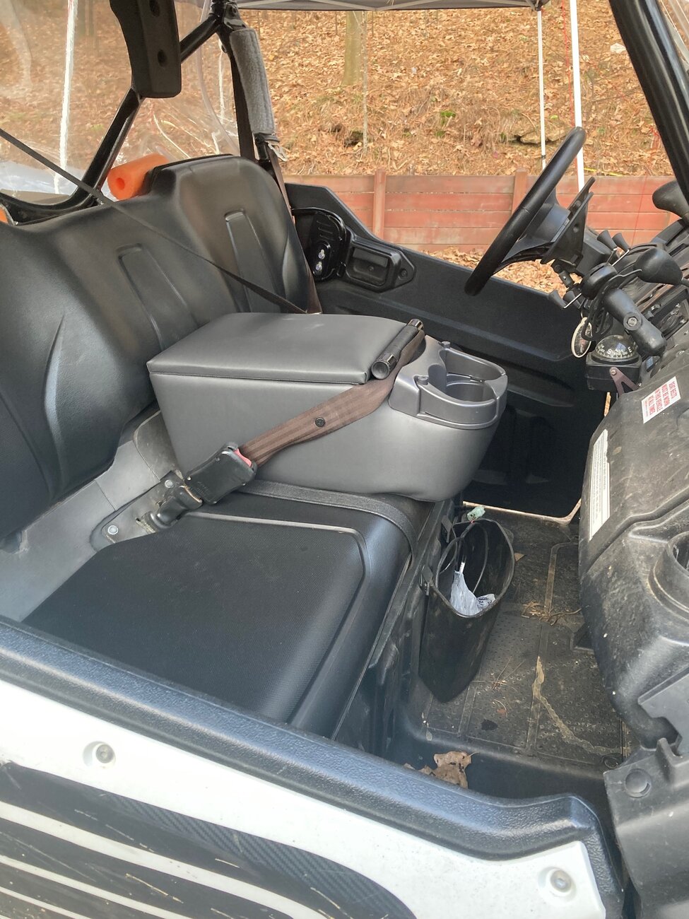

Did thisa while back and just got around to posting today while snowed in here in Arkansas. Found this console at Tractor Supply. My wife has been asking for one for a long time. The center seat belt is a perfect "retainer strap" for this console. If we need the center seat, we just unbuckle the seat belt and pull the console out. Works a treat! View attachment 317484
Is this the one with the clipboard under the console lid? Don't see it on TS website but I found one that looks the same on Amazon. TIA
That is the one. I think that TS no longer carries this item.
