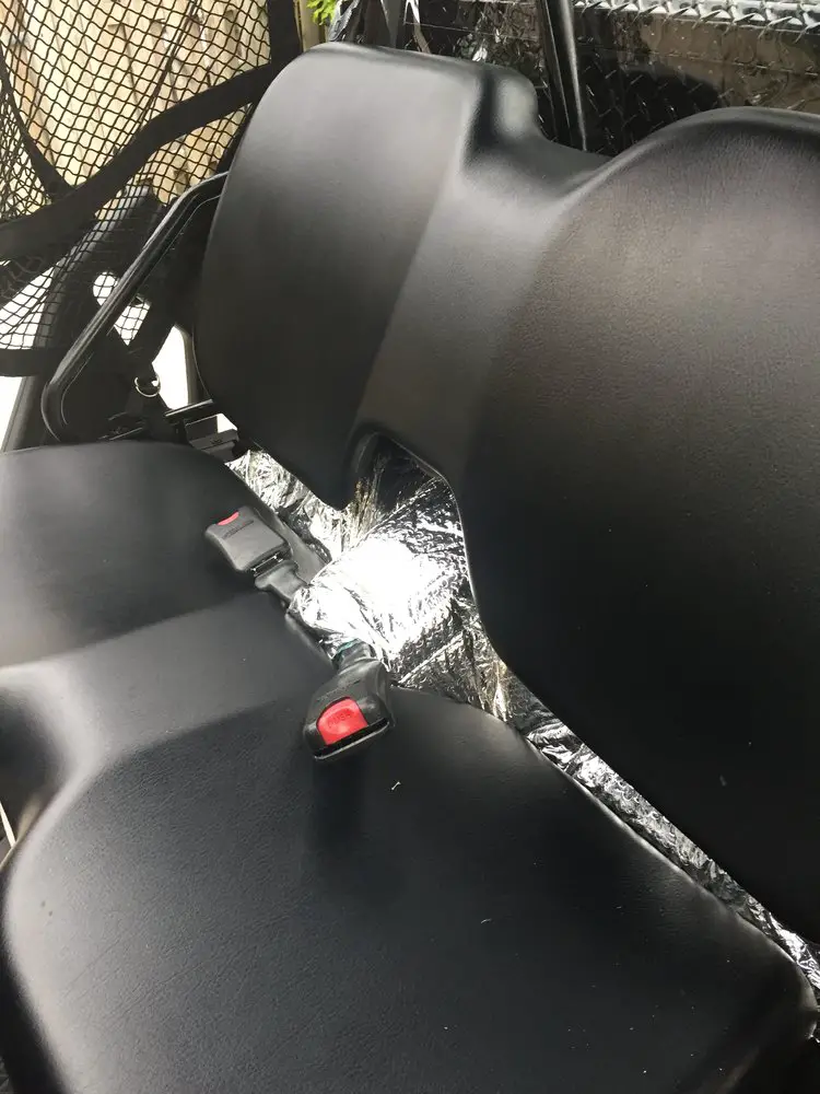

IMG 2919
I am thinking about each panel below the seat, It only gets hot in the center, but there are some open holes in that area and I am not surer this would work.
I just use a Mylar windshield shade, it's cheap, lightweight waterproof and easy to install and clean. And it works great no heat comes thru . I had a extra one laying around and tried it. Very happy with the outcome.
