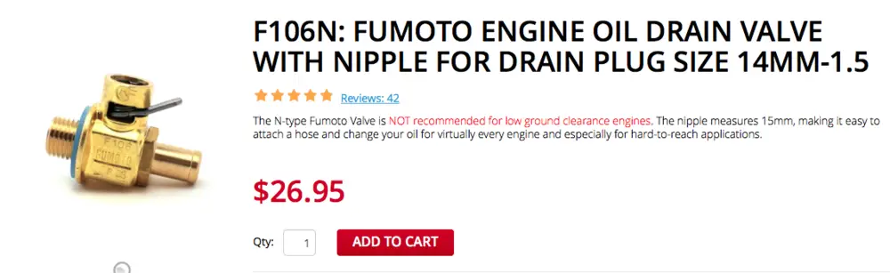

what about those quick change valves that install permanently then u run a tube off of them? they make them in a lot of thread styles etc the one below is (not the thread u want but just a thought) might not be applicable I haven't done first change yet so don't know the angles etc
I use those on my trucks and love them. I would use them on the pioneer if they made the correct size. I called them, they don't make a 8mm.
I haven't looked into an adapter yet.
