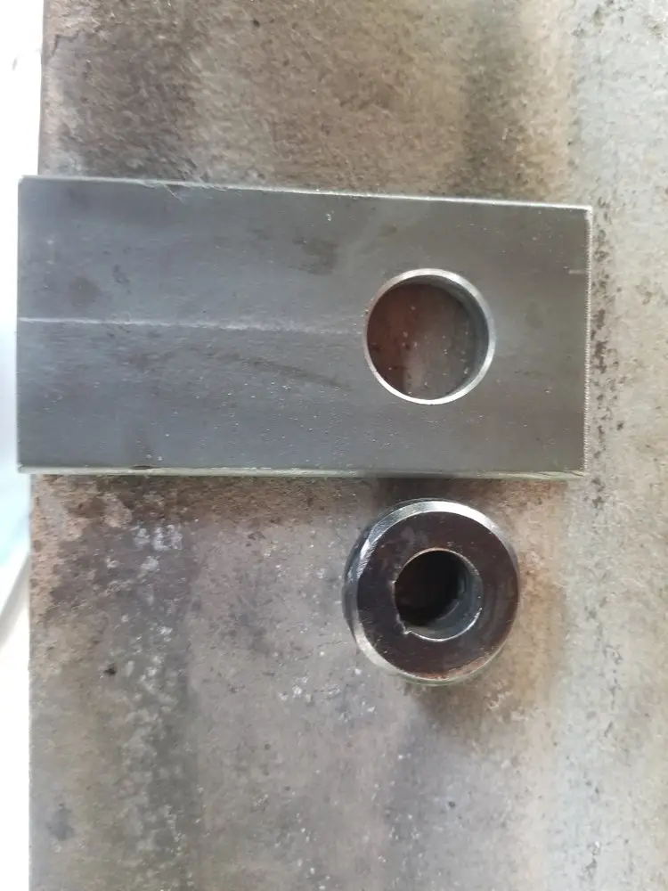

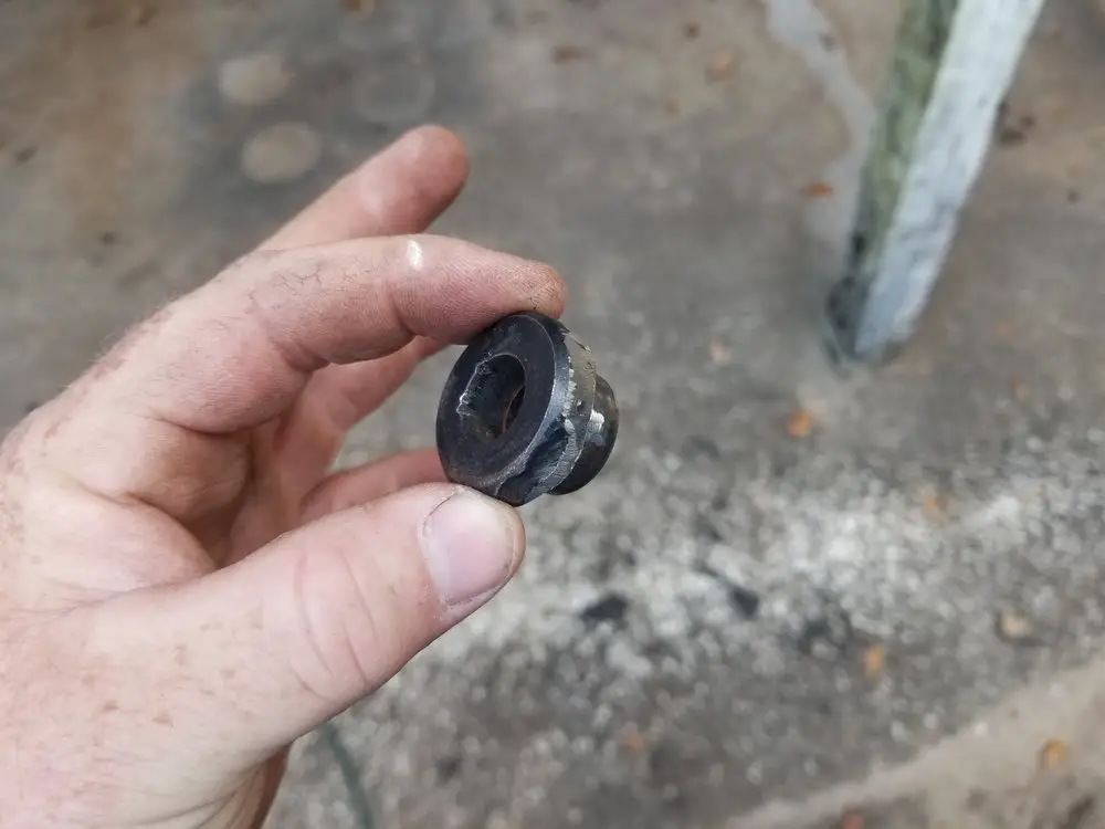

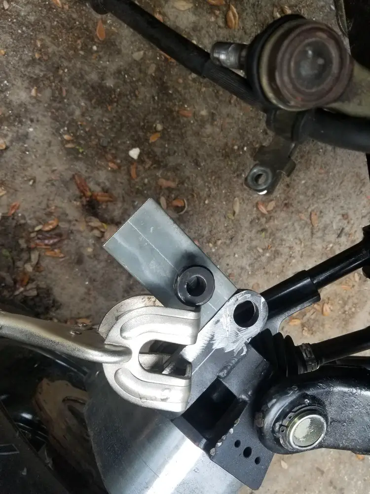

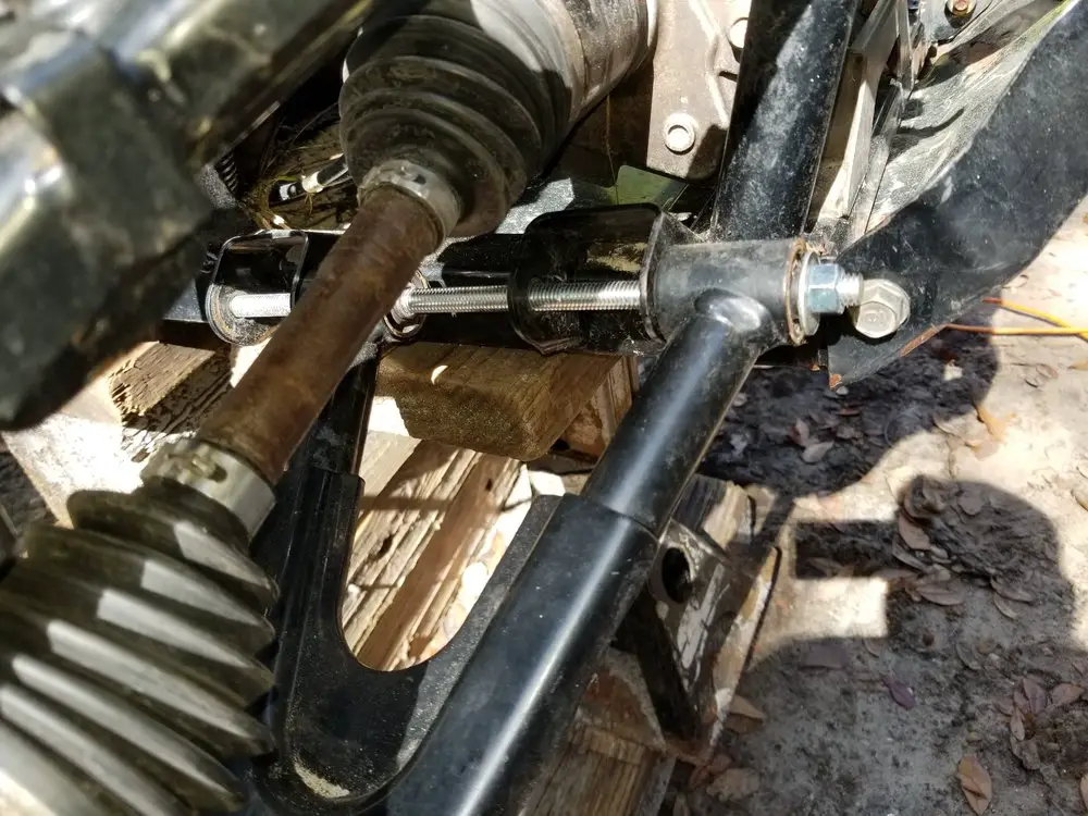

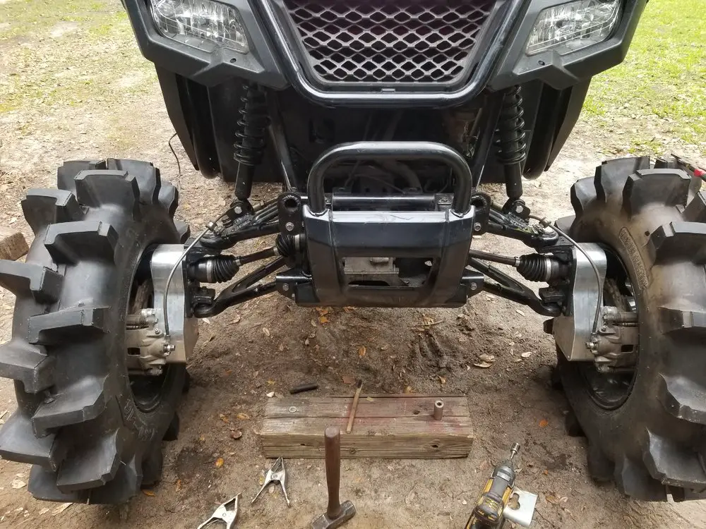

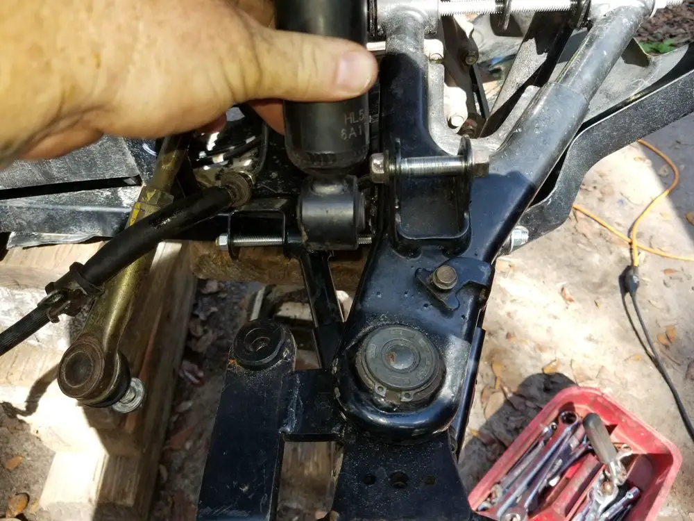

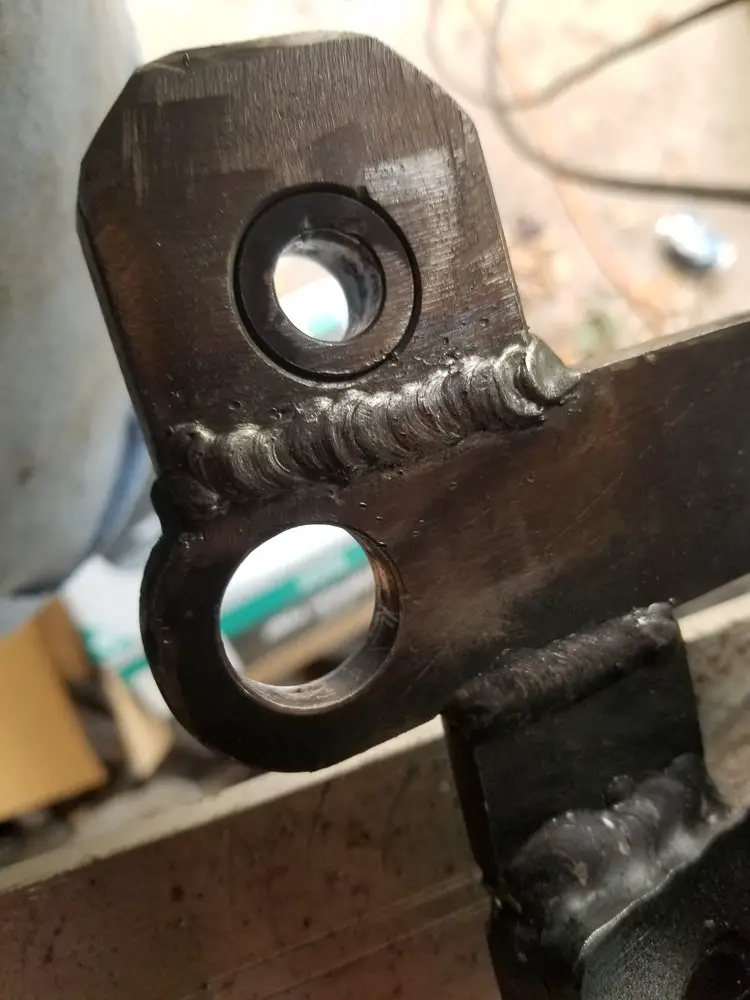

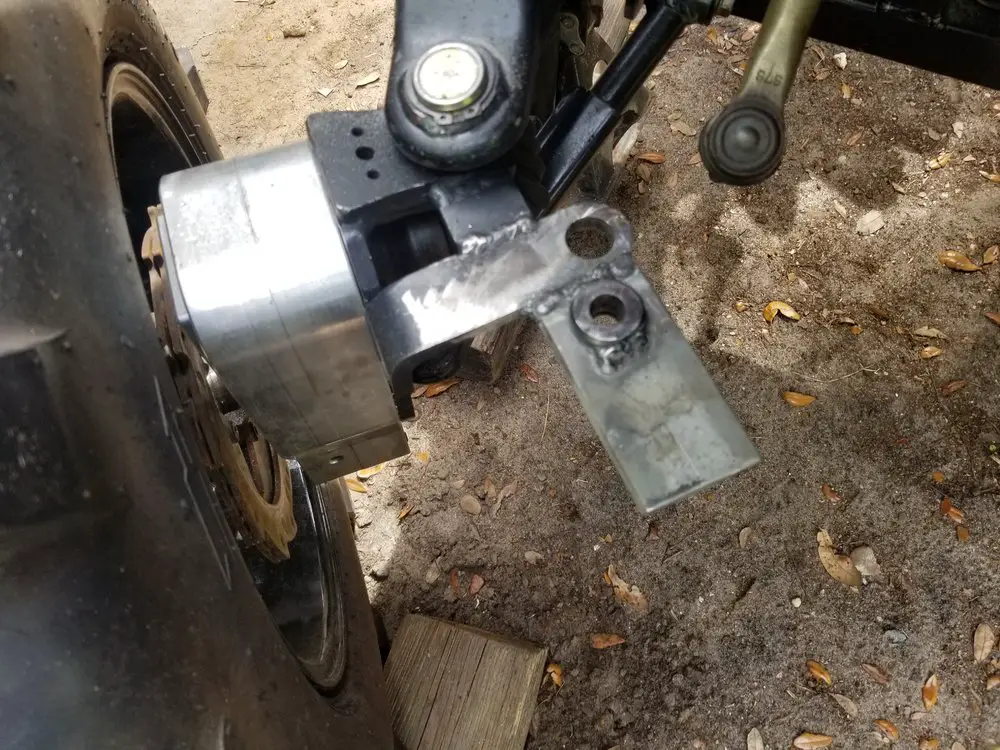

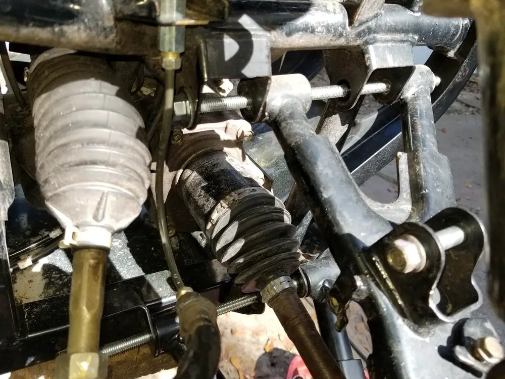

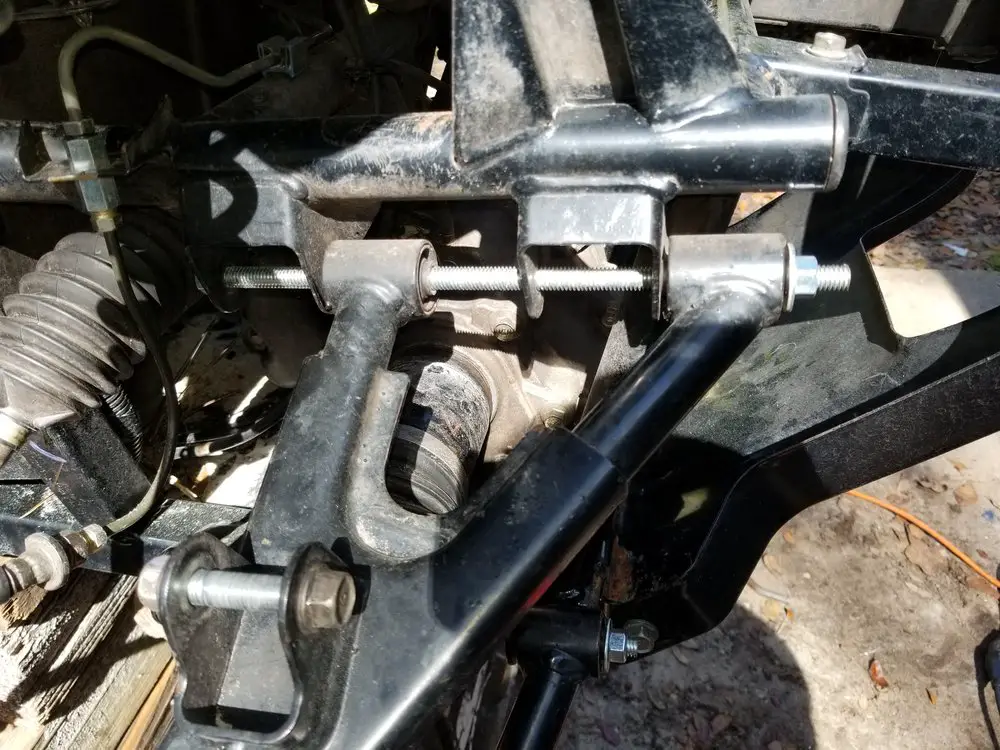

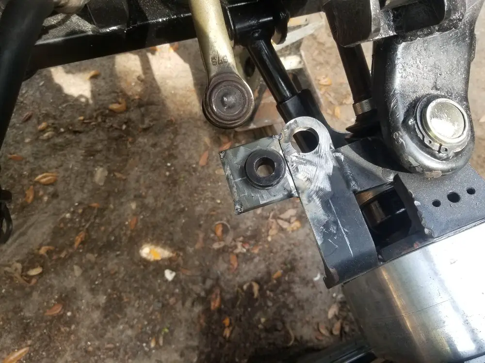

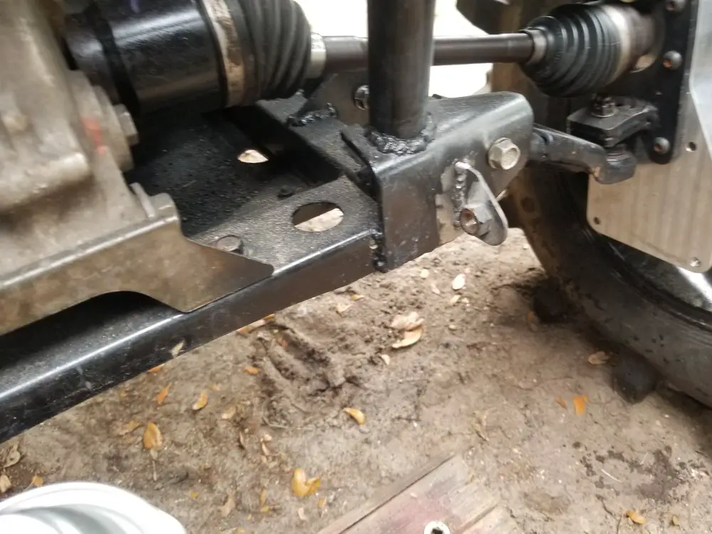

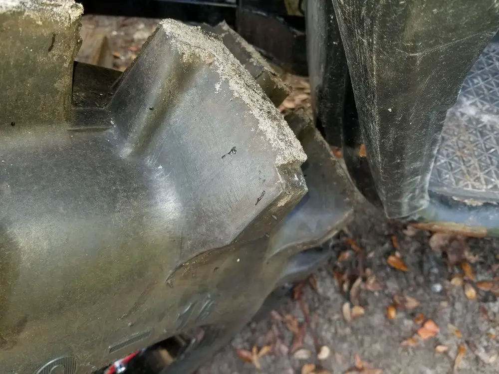

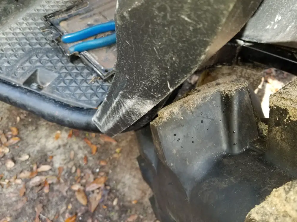

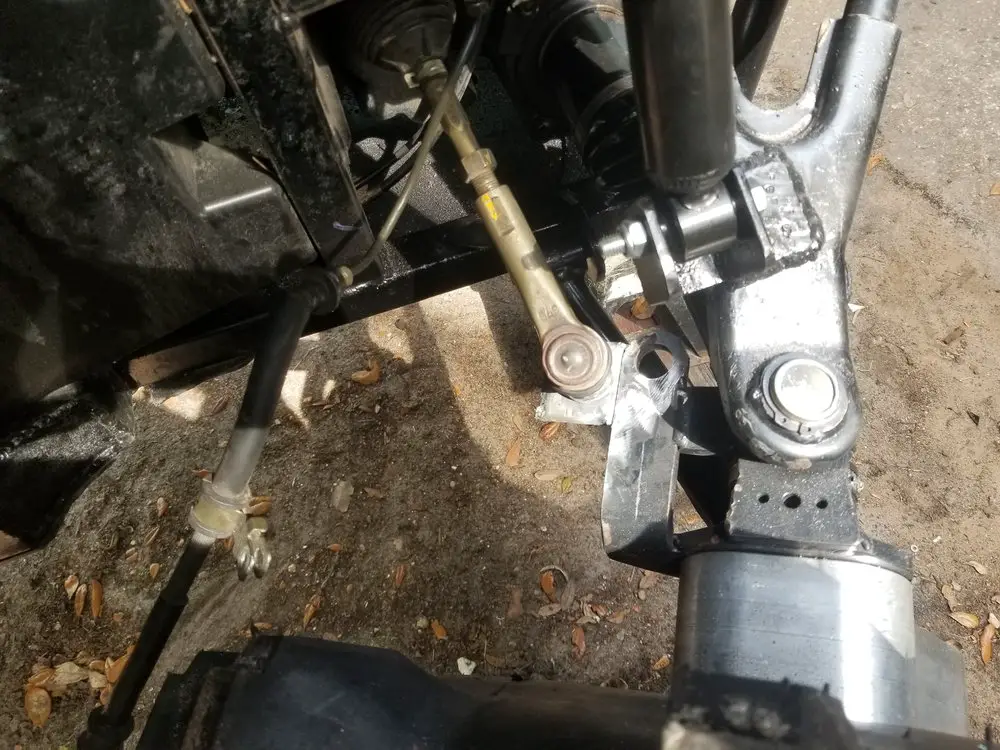

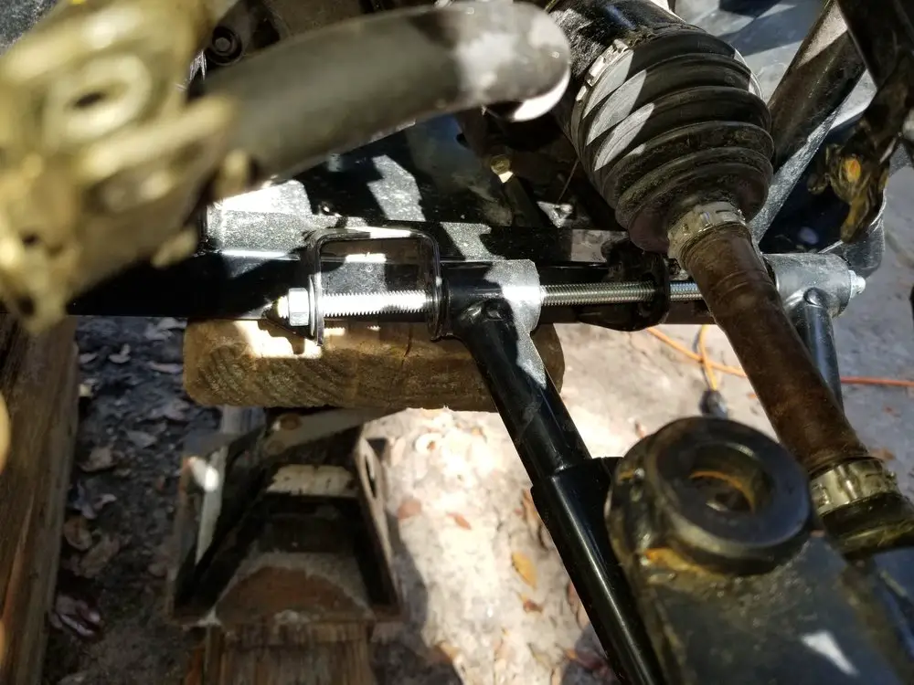

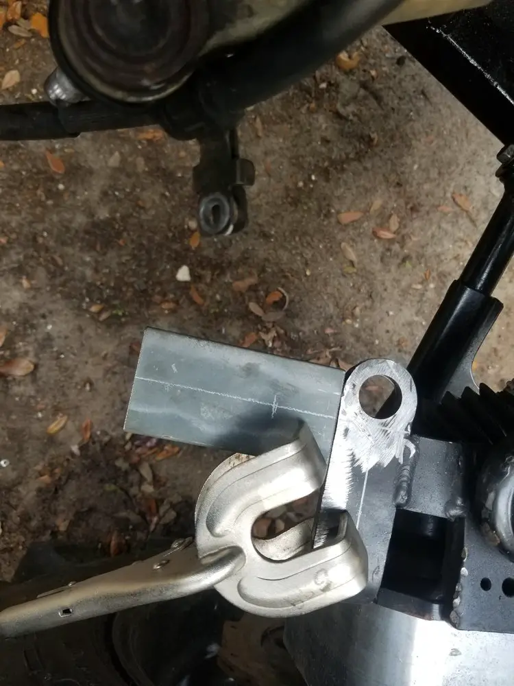

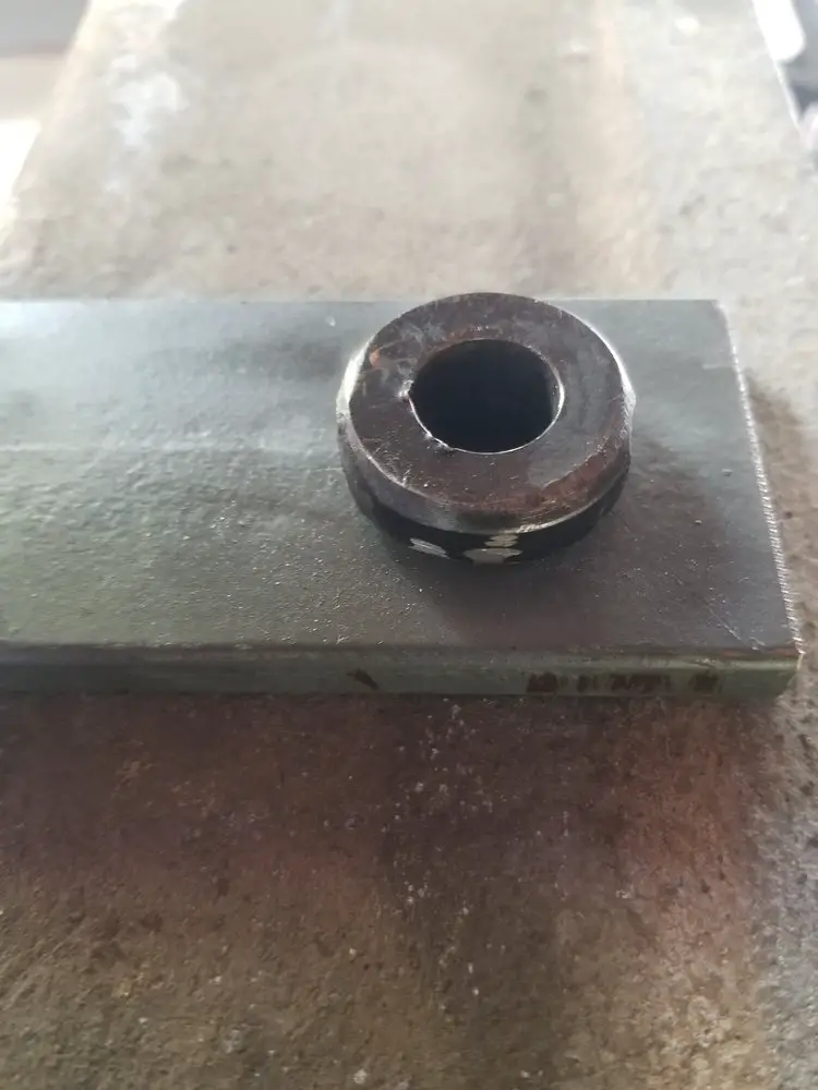

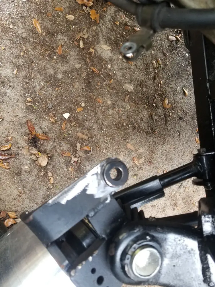

Been kicking this idea around since i got the portals. The tires rub on hard turns, so i thought about moving the a-arm mounting tabs forward on the frame to get the tires a couple of inches forward. I plan on just unplugging the a-arms, moving them forward, just on the front side of the tabs, and using one of the tabs, and welding a new tab in front of the a-arm bushing. Dont know if that made sense. The pics will tell you better than i can. I got a long piece of 3/8" threaded rod and washers and nuts from Tractor Supply and im using that to lign everything up. I cycled the suspension and there doesnt seem to be any binding from the new forward position. Gonna work on the passenger side today, and the drivers side tomorrow hopefully. Im slow at doing these types of things so hopefully i dont run out of weekend. Heres a few pics. Ill post more pics of the progress later this evening. Youre probably wondering why dont i just buy forward a-arms. Well, the one company that used to make forward a-arms for the P5 has become unreliable. Also, i like projects.
View attachment 66233 View attachment 66234 View attachment 66235 View attachment 66236 View attachment 66237 View attachment 66238 View attachment 66239

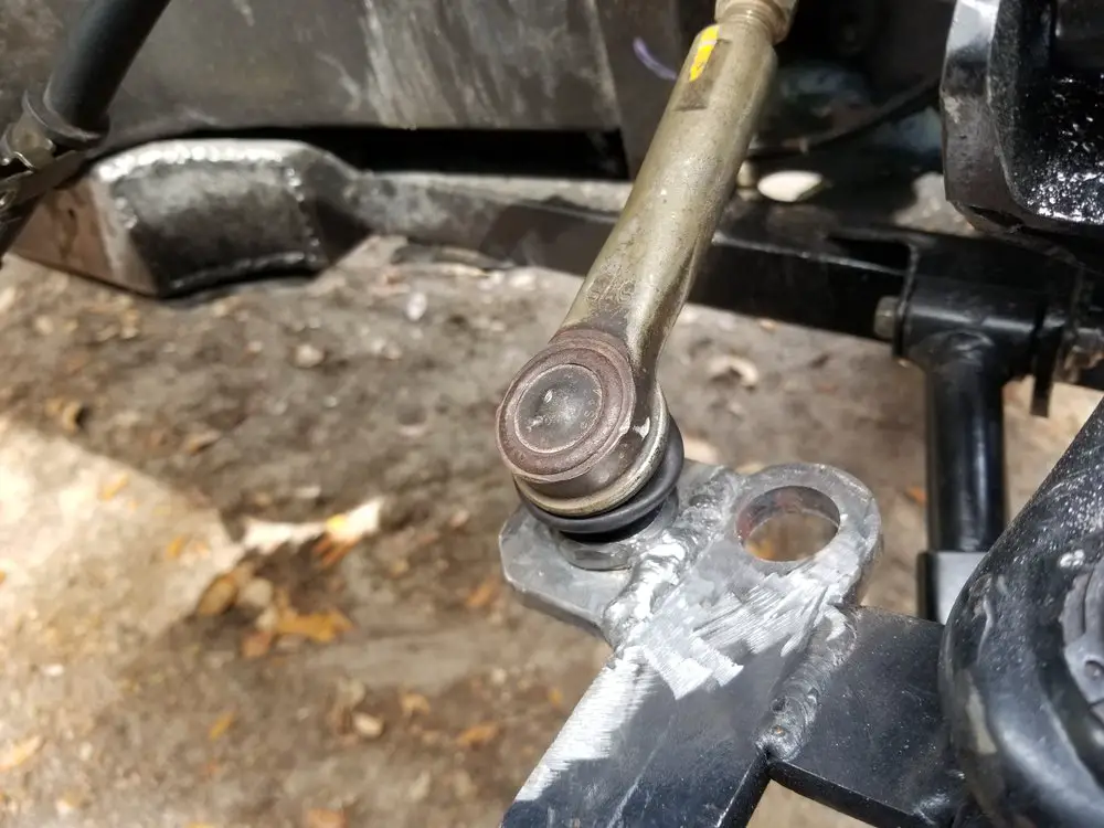

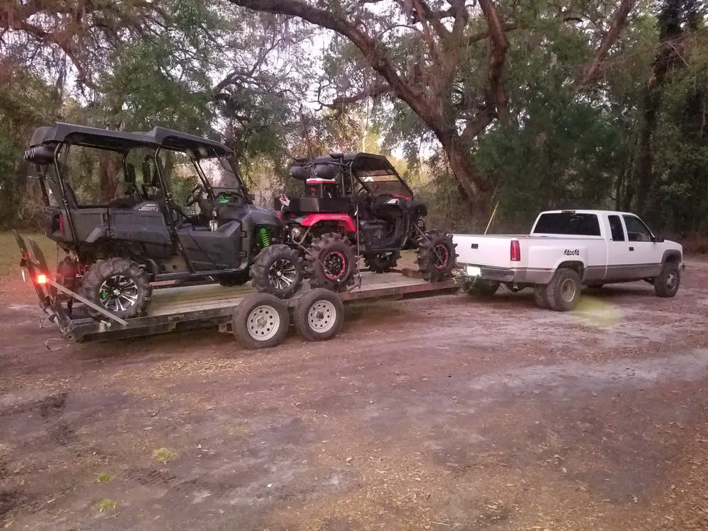

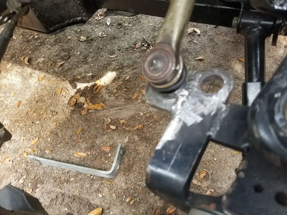

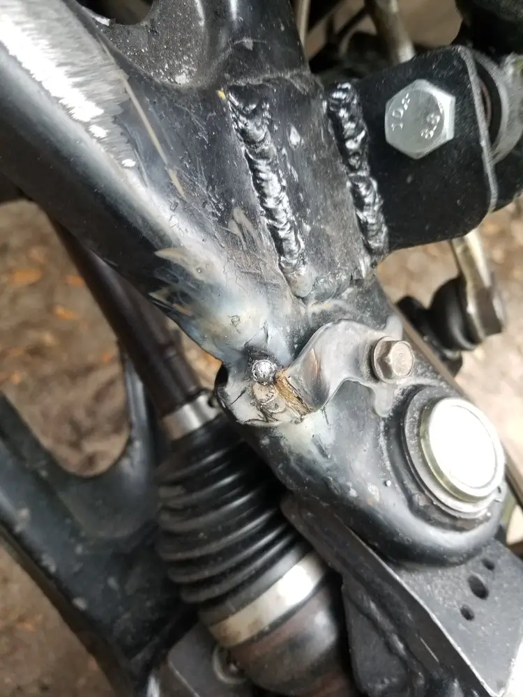

Ok im all done with this mod. Got it all back together and loaded on the trailer with Sugar Pies P700-4, gassed up, beered up, ready for muddin tomorrow at 10k. I had to play around with where to put the balljoint hole location to get the most turn that i could. It doesnt turn as sharp as i'd like, but it will do. When i moved the hole 2" back i lost a lot of the steering. Thats when it dawned on me the further the hole gets away from the knuckle pivot point, the less i would be able to turn. So its about an inch back, and a half inch towards the outside. I unthreaded my balljoint things on the steering bars back out a half inch about where the factory had them. I welded my lower bumper brackets back on and put the calipers on. I put the sexy braided brakelines i got from @jak9922 and got the wife to pump the pedal while i bled the brakes. Took her for a spin and it drove good. The steering is nice and light again like from the factory. That could be the new balljoints, or the location of the steering balljoint holes, i dont know. Got her loaded and ready for tomorrow. Anyway, heres some pics. Im calling this done.
View attachment 68292 View attachment 68293 View attachment 68294 View attachment 68295 View attachment 68296 View attachment 68297 View attachment 68298 View attachment 68299 View attachment 68300 View attachment 68301 View attachment 68302 View attachment 68303 View attachment 68304 View attachment 68305 View attachment 68306 View attachment 68307 View attachment 68308 View attachment 68309
