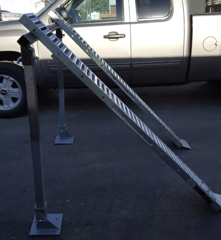

Small box does complicate it a bit, out friend that comes up with uses this
C69B1E8A 8946 4A91 8C41 D4EA3E493BD6
94220A77 C99D 4DFA A05C AC19AF177D7F
Works well with his quad but we also checked it with our Wolverine and it would work, mileage would obviously suffer but think 700 would probably fit too

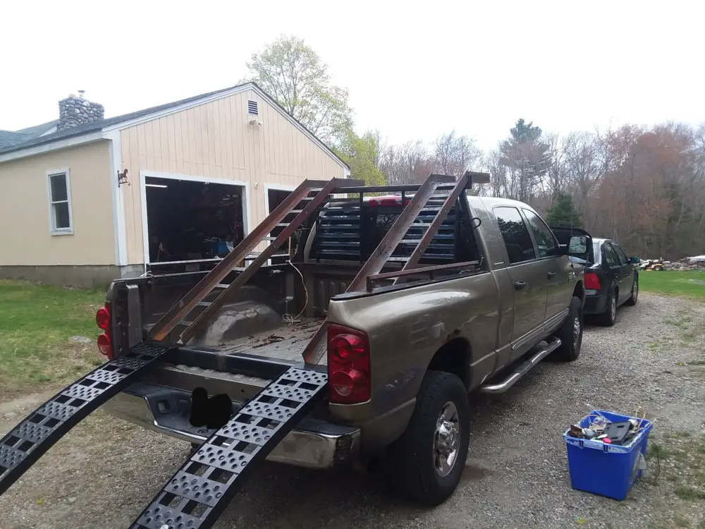

So I didn't get as much as I thought done (big surprise) but managed to build the carrier ramps. Probably oversized, its 3x3x1/4" angle with 1-1/2x1/4 flat stock bridges. It's what I had kicking around. They are a bit heavy, but manageable. Probably about 80lbs each. Will cut up some expanded metal and tack it down for better traction, then work on pinning it all down while staying removable. Then paint.
Did break down and buy some reese 3k lb aluminum 1 piece loading ramps, they were $220 at tractor suppy. Did not have enough 2" angle to build them so these were probably cheaper than buying steel and making my own. Not sure about the rating but they hold the 700-4 just fine.
20190427 203118
32,050
So I didn't get as much as I thought done (big surprise) but managed to build the carrier ramps. Probably oversized, its 3x3x1/4" with 1-1/2x1/4 flat stock bridges. It's what I had kicking around. They are a bit heavy, but manageable. Probably about 80lbs each. Will cut up some expanded metal and tack it down for better traction, then work on pinning it all down while staying removable. Then paint.
Nice I don’t trust my welds that much.
