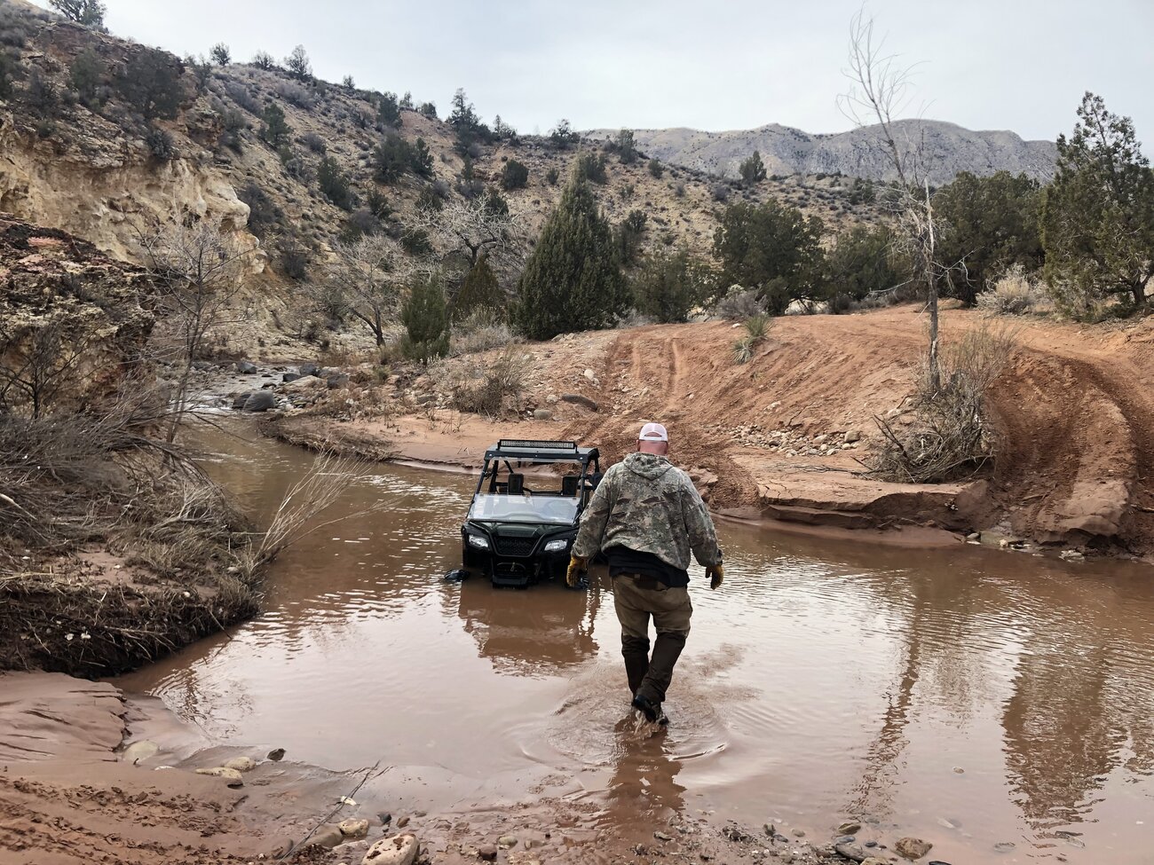

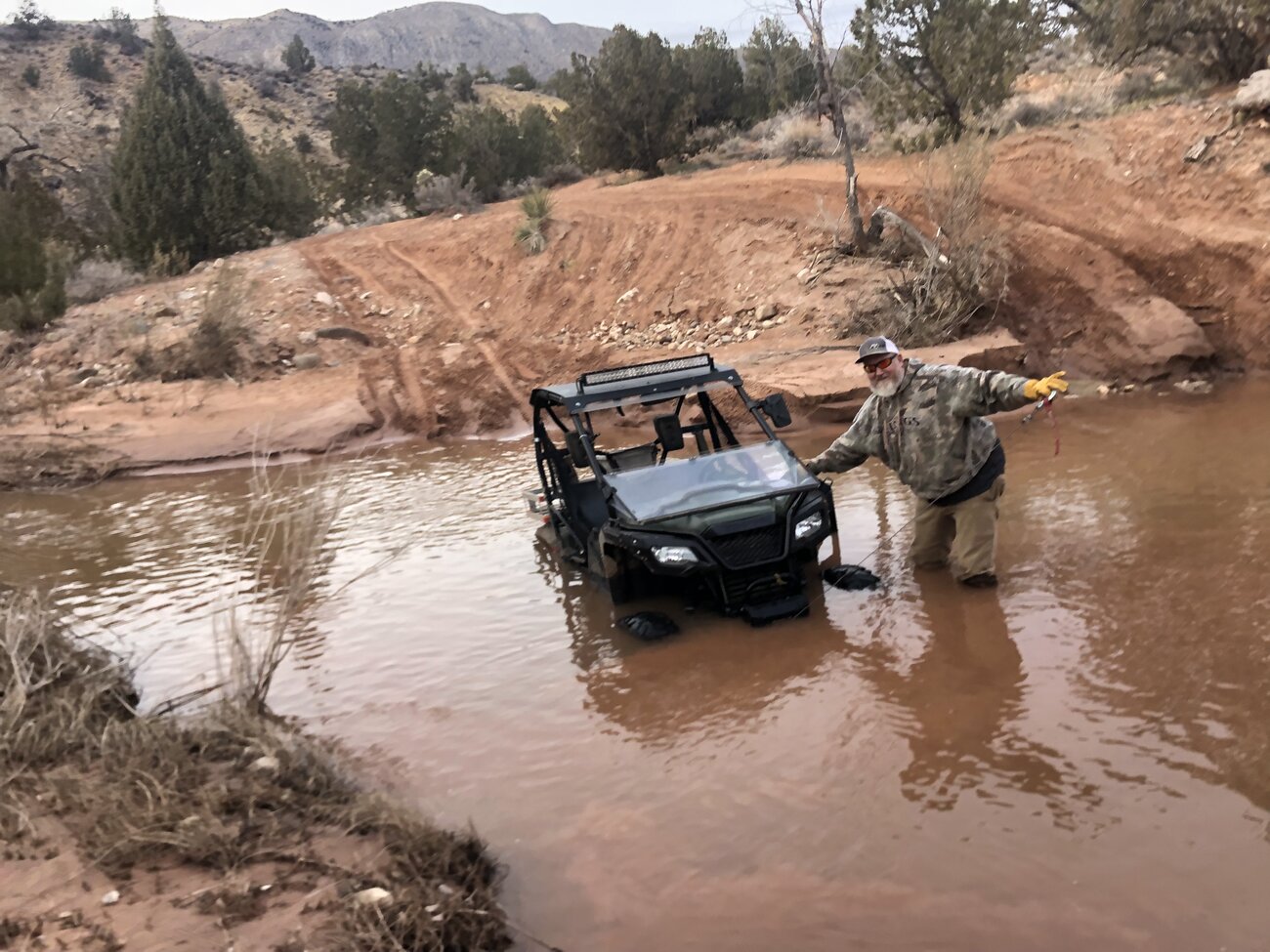

Do u have some pics of it swamped?
#POIDH
These are the only pictures I have
4117D9B5 1E9A 40A1 8A4C 269F9A71A80D
B0CB0B96 7B65 4EF3 A4E4 08715D063C19
20,161
115,304
Looks like a snorkel and extended vent tubes in your future…fyi check your diffs for water, good time to replace with synthetic.
He already changed those fluids.
But you are correct about snorkeling it. Would have helped for sure
