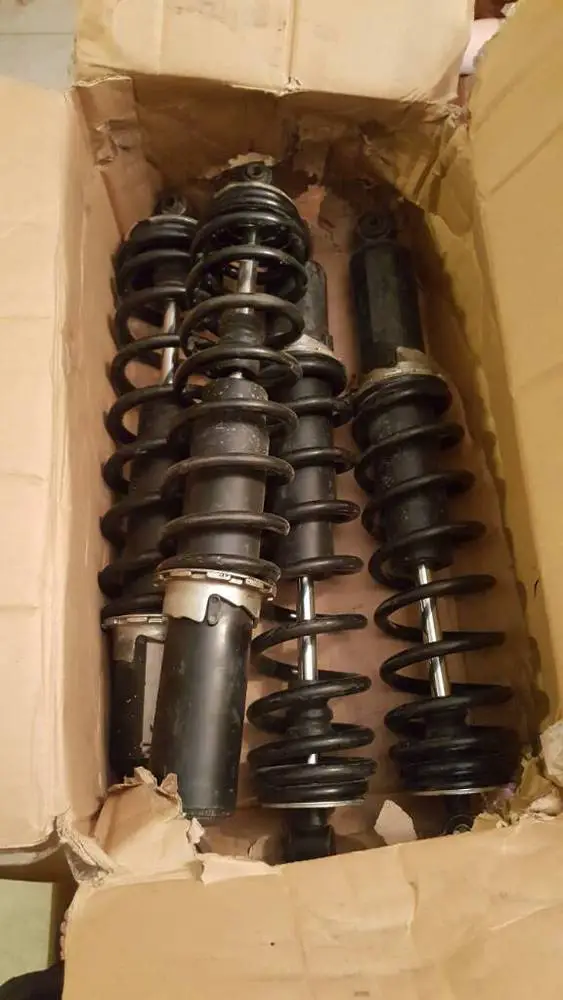

Update! Got the front shocks on. Stock measurement from front skid plate to ground was 10" after installing can am shocks (set to lightest setting) measurement was 13". That's insane lol. Haven't had a chance to test drive yet with them on. Waiting on poly bushings, that are in the mail on the way, and I'll do the back.
