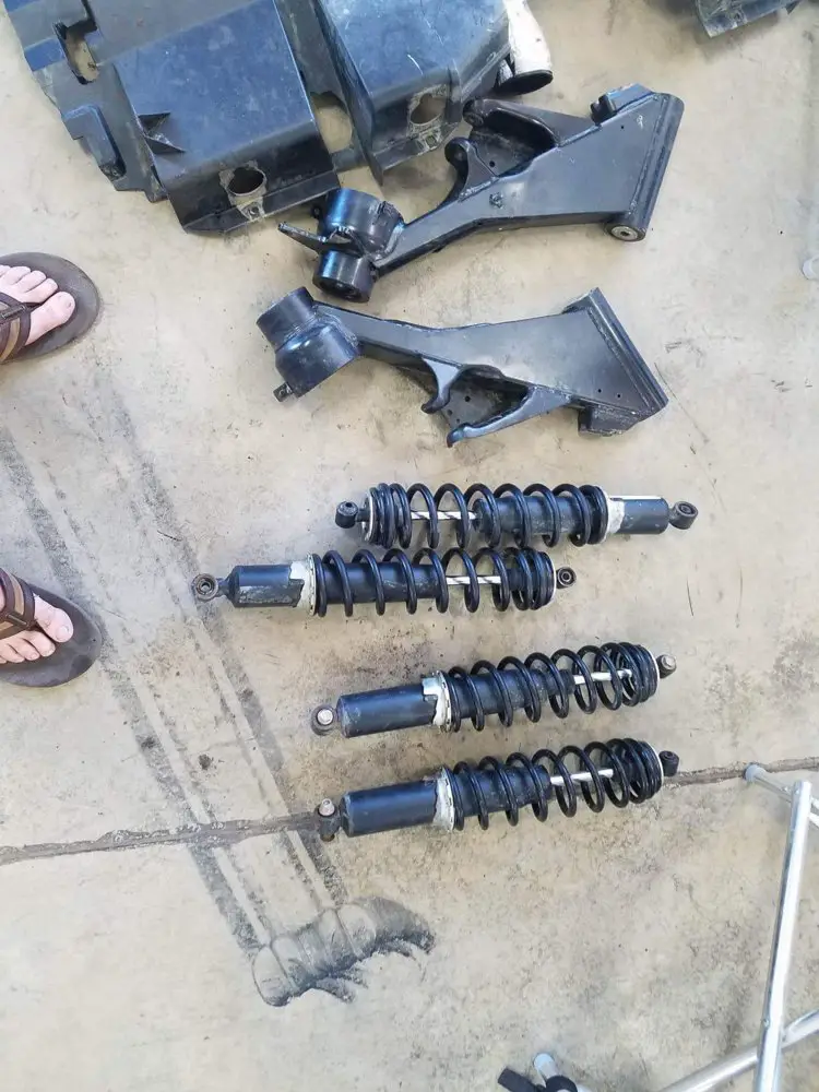

Please help!!
Will 2011 commander xt shocks with black springs work?
Received 855793767240

Getting them for 300 with 600 miles on them, sounds ok?
A little expensive from what I have been seeing them go for but not that terrible. Try offering lower.

They were going for $150-$200 earlier.
I think your guy is asking a little much too.

Why couldn't you have found me some for $200 when I purchased mine. I could only find 2 or 3 sets and 1 guy gave me the run around for a month. Even at $300 that's still 1/4 of the price of Fox shocks and that's not even going to lift it like the XT's will do. Spyfid has fox shocks and he stated that the XT's ride as good as the fox shocks do on his ride. Sooo $300 isn't bad..when considerin 1200+ for full set of fox's and $150 for a lift kit to be equal to the XT's at $300.

I guess you are right. I remember you were getting the run around from that guy when I bought mine.
I got em for $150 plus shipping. But maybe that is very low and shouldn't be expected every time.
I retract my first post and say BUY EM! You will never be more proud of a $300 modification.

I offered 250 and he immediately rejected saying the are over 200 a piece brand new, I will pay the 300 cause I really want to do this modification. Plus like y'all say you get better then or equal too ride as the Fox shocks for way less and a lift kit.
