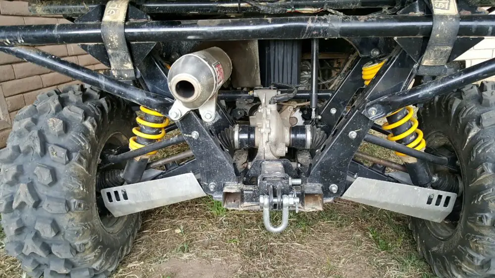

How my rear Canam shock modification install went......
Raised and properly support the rear of the SxS
Remove rear tires
Remove sway bar A-arm mount
Remove upper A-arm bolt from spindle
Remove stock Honda shocks
Remove Canam shock bushings. I knocked them out with a hammer and punch...properly support the shocks!
Install proper sized nylon bushings and steel sleeves using supplied grease. Be careful while pressing in the steel sleeves! The last sleeve I installed was off center and destroyed the bushing. DOH!
Install Canam shocks by pushing down hard on lower A-arm to fit new longer shock into the mounts
Reassemble your SxS.
I noticed there was a gap between the lower shock eye and the mount. I figured the shock could move on the bushing between the lower shock mount. I cut spacers from 1" PVC conduit....materials on hand...a steel spacer would be better!
I am waiting for a new bushing so I can finish up this install and take it for a test ride.
Rear shock spacer
Vato
Vato
Oct 3, 2015
180
159
Finished up the Can Am rear shock installation.
Just like the lower shock mount, there is a gap between the upper shock eye and the mounts. I will keep an eye on this and install spacers if the shock's eye moves on the nylon bushing...I suspect it will.
Disconnected the sway bar and wired it out of the way for testing. There is more noticeable body roll while cornering with sway bar disconnected. I have the 700-4.... maybe due to the extra weight? I adjusted the shocks several times and the roll is still definitely there and gets my attention while cornering. I will ride for a while with sway bar disconnected..... my gut tells me to put it back!
Shocks are amazing and way better than stock. Firmer smooth ride with more positive steering and just a better ride. I would suggest this affordable modification for the 700.
I want to thank those of you who Pioneered this shock modification. Not sure if I would have even thought about using Can Am shocks on a Honda?
My buddy said his 700-4 on 27" tires felt too too heavy after I convinced him to disconnect the sway bar. I took him out in the field and slide it side ways in some hard cornering just to show him.
It will feel a little different but give it some time. The traction and smooth ride will be worth it.

I am going to ride it for a while with sway bar disconnected. It feels weird and maybe I just need to get use to it. I know that energy is stored up in a hard turn and the roll can get out of control in an instant and over you go or if your lucky you spin out. With the sway bar properly installed that energy is distributed over the rear suspension while in a turn...they stiffen against the roll tendencies a suspension has while turning corners at speed. As one side compresses it loads the bar (which is really a torsion spring) with many lbs, it in turn transmits those lbs to the other side trying to even out the differences in ride height from side to side by taking the energy that is compressing one side and shifting it to the other side. I am thinking the stiffer shocks/springs might help the roll tendencies of the 700. We shall see. I'll know after a few more hard rides...starting tomorrow! :D
