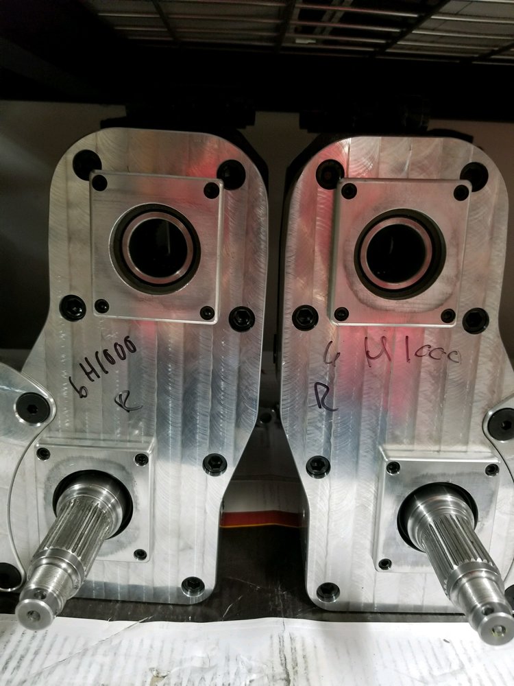

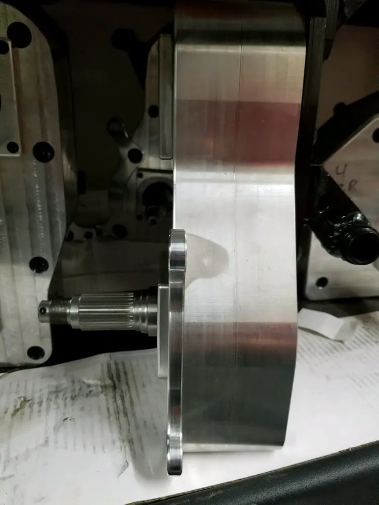

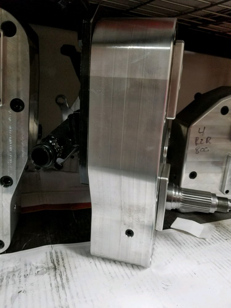

Well, i just pulled the trigger on these...6" portals from utvsolutions.com... I dealt with a guy named Chad up there. I think they are up in Michigan i believe. He took these pics of a set he had on the showroom floor up there and sent them to me. I imagine it will take a few weeks or so to have them built and sent down to me. Lets hope my research pays off, if i was wrong about these being able to fit a P5 i guess my wifes P7-4 is about to get hooked up! Lol

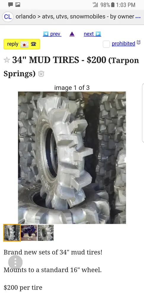

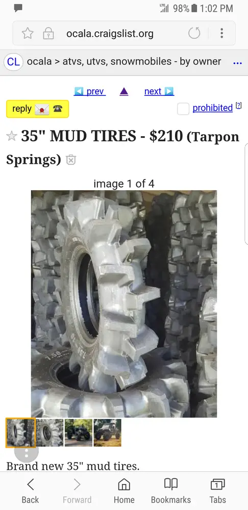

I was thinking of driving a few hours south of me and getting these tires, they are superior traction tires, 34x7.50-16 for $200 each, or 35x7.50-16 for $210 each. Not sure though, the guy i talked to on the phone seemed less than enthusiastic to be talking to me, and when i mentioned bringing my P5 down there with the new wheels so we could mount a tire on the wheel and check the clearance on the machines frame and stuff, he said they dont mount tires, they just sell them. So i dont know if ill deal with them. We'll see. That is a crazy good price for tires that size though.
View attachment 62452 View attachment 62453 View attachment 62454
Good for your wife, I was really looking forward to seeing them on your P500
View attachment 62459 View attachment 62460
those tires look insane,something off a paddleboat !
