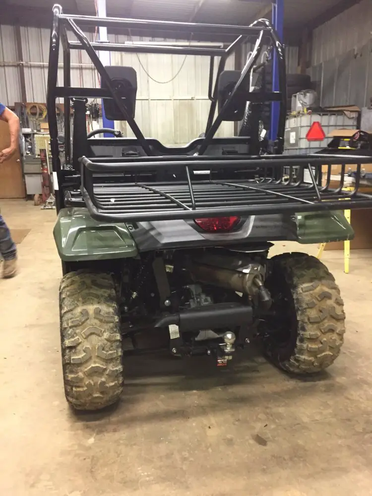

Here’s my rear rack!

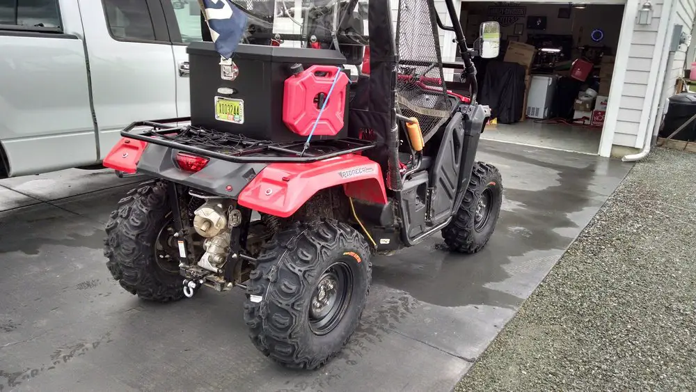

Great ideas guys, lots of really great options. Mine is rather plain, it’s just a poly tub that I bolted to the stock tube rack. Typically in fire season, I pack a piss can back pack, (ratchet strapped to back of cab inside tub), chainsaw and other work type gear and it works for my needs. I like it as I often carry different stuff pending needs and it’s light surprisingly strong.
Thought I had pix in my link.... guess not, I’ll try to find some.
j
EcoPolyBlend™ Spill Tray twenty- Gallon Drip Tray | Justrite® - Justrite
No specific pix mounted on my P5 but above link is what I used. Took some aluminum flat strap placed inside tub at the rear and bolted through tub and rack, with SS bolts and nylock nuts. In side front corners, used short pieces of aluminum angle bolted same way, with the up right angle drill for tie downs. Tie downs on the rear flat bar i used para cord loops. In one rear corner drilled 1/2” hole and boat plug for drain. This tub seems flimsy, but is surprisingly robust material, has not torn, ripped, cracked and is strong.
