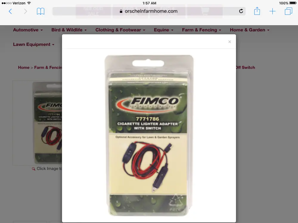

My sprayer came with a cigarette lighter plug as well as alligator clips. If I'm using my Polaris Ranger I use the alligator clips because the battery is under the hood, and if I'm using the P5 I use the cigarette lighter adapter. If yours didn't come with one you can purchase separately at Tractor Supply. If you get this one, it also has an inline on/off switch which is very handy.
Btw, what I suggested in post two is to be used only if you're occassionaly strapping the sprayer on for use. If this is to be a permanent mount situation for you, then by all means hard wired, fuse protected as @PistonHonda said is the way to go.
Thank you. That plug should work perfectly for my occasional use.
