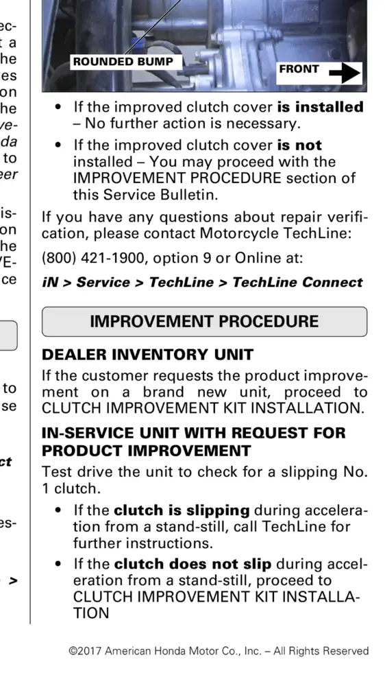

Yeah I will push back. I told him that we do long rides deep in the bush and I didn't want to wait to be stranded before it's fixed. He was sympathetic but said his hands were tied..
Are you sureo_O The way I understand it you should be eligible!
IMG 1124
35,967
212,774
Here are the part #'s for those who want to tackle this on their own
  • Clutch Cover - 06113-HL4-305
  • Associated Service Parts - 06113-HL4-307
Honda allots 1.6 hours for the job completion.
Heck no, I paid for service, and I'm going to get it, come Hell or high water!

Techline is taking slipping clutch and new sales units as priority first. Everyone will be eligible eventually but for now (due to low inventory) they are fixing those two categories of units first.
