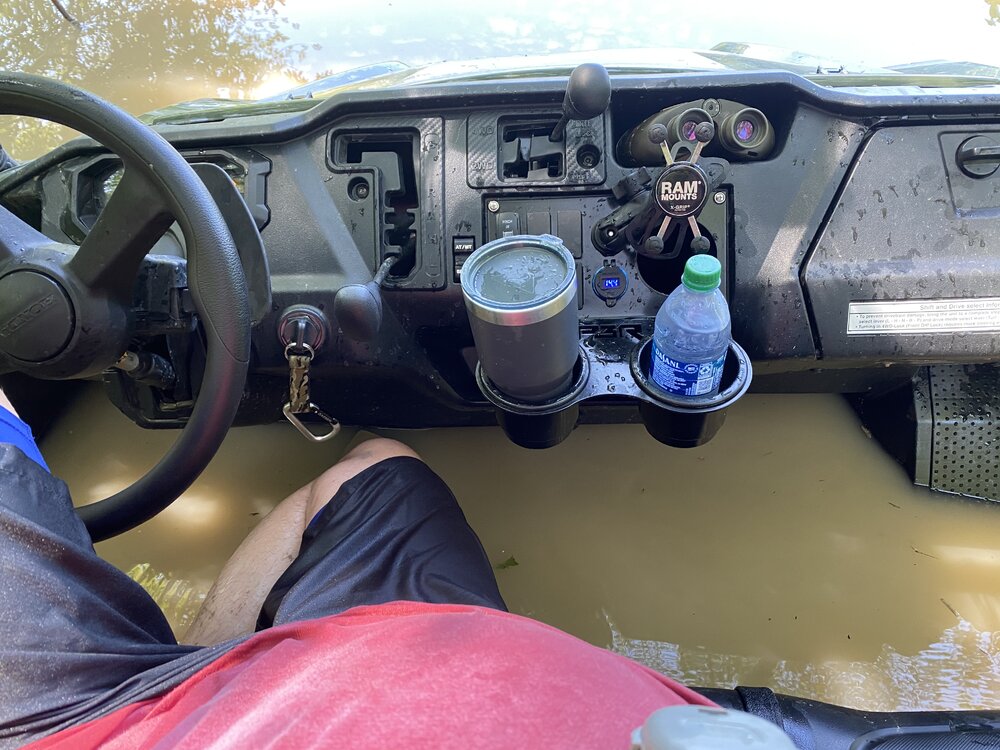

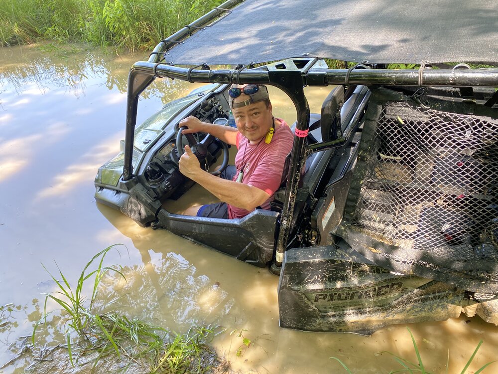

So i went ahead and did this (honestly thinking that i would never need it - as i mostly work with my pioneer around the house...).
Fast forward a couple weeks.....
