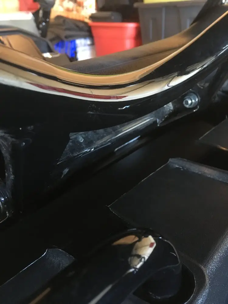

So I’ve ran mine up behind the seat in between seat and air filter box pointing downward. Think this is a good spot? Do I need to worry about dust getting up my vent tube or is it always positive pressure coming out? Thanks guys!
You can see the top of vent tube going back downward.

Still had to google what you guys were talking about, I got it now, lol. Yeah we have them little bastards here.
I thought about running up to roof but didn’t want anything noticeable. Like a gas line zip tied up the roll cage. Lol.
