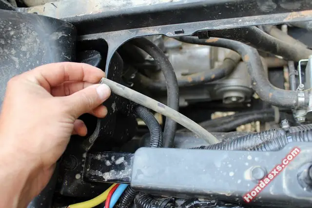

Here is the Pioneer 1000 vent tube under the passenger side of the front seat, I am simply inserting a 3/16" barb and adding 2 ft. of 3/16" hose and running it up the back of the seat. The hose coming out of the white plastic fitting going into the frame. Pull out of frame add barb + add extended hose and run and and secure as you see fit.

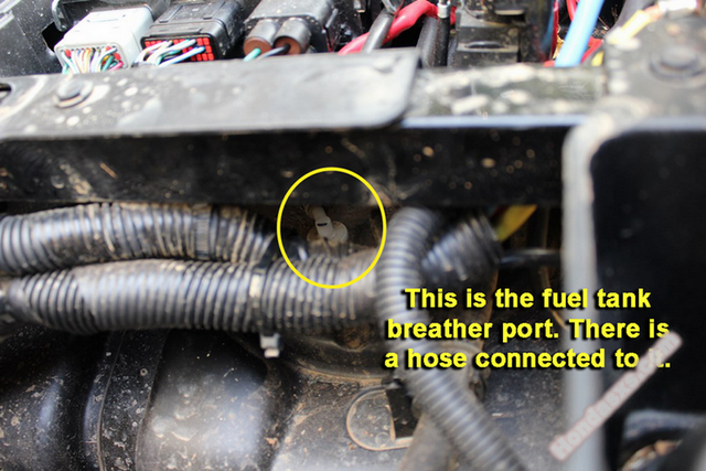

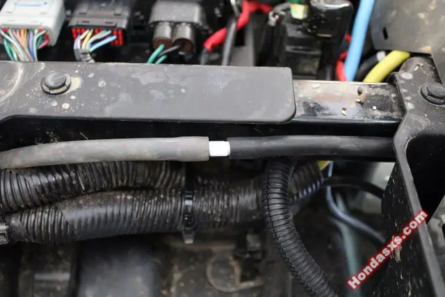

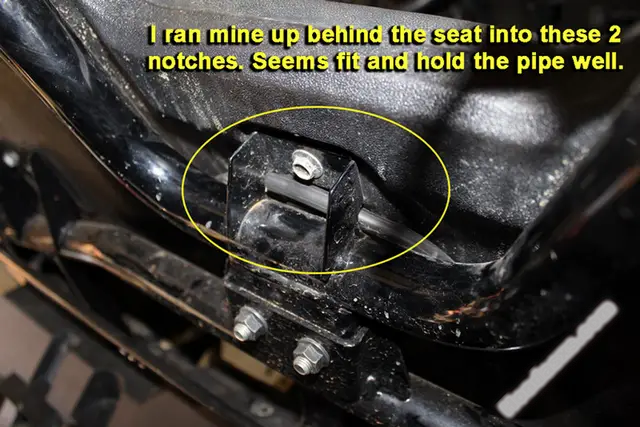

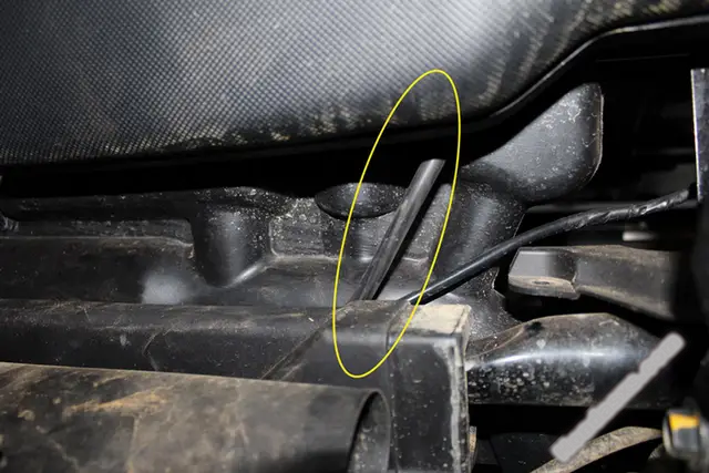

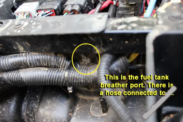

Recently I have read at least 4 post where riders sunk there Pioneer. Now being its a HONDA, once you clear the vapor lock, drain the air box, and muffler it should crank right up.... But this was not the case.
Come to find out the fuel tank was contaminated with water in all 4 machines.
Being I am not afraid of the water I figured I needed to look into this before I became a victim. Well good news, I have figured out why so much water gets into the fuel so quickly...
Here's a quick video to explain.
Ok, ok... so the video is not exactly what happens but hopefully you can get the idea.
The fuel tank on the Pioneer is right beside the HOT motor. There is no doubt both the fuel and the air inside get fairly hot. Now, once your tank gets submerged it quickly cools and that creates negative pressure. Since the Pioneer is under water so is the breather hose for the fuel tank. Instead of pulling in air to relieve the negative pressure it pulls in water like a fire pump. Oh no... BAD day for you...
So, Please...
SNORKEL YOUR FUEL TANK BREATHER HOSE.
This has been a public service announcement brought to you by HondaSxS.com
Thank you!

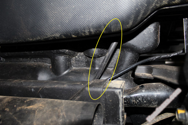

Here is a few pics of what I did Friday.
View attachment 1530 View attachment 1531 View attachment 1532 View attachment 1533 View attachment 1534 View attachment 1535

This is a important PSA that needs to be pushed back up...
Guys. This issue has claimed more rigs then I can remember. Even if you wish to keep your rig factory. Please consider doing this up to seat back level.
There are reports saying that even leaving it out in heavy rain can flood your tank. It's thought the frame holds water and enters the OEM breather location.
Please. $10 and 20 mins can save you a world of trouble.

Hey guys I’m going to get mine extended tomorrow. Where are you running the extension tube too? Where’s the best place?
20,256
115,878
On a P1, I ran mine up the middle roll cage passenger side and zip tied it to it. Went all the way up as high as I could go.
Reactions: TheHoover
35,596
209,962
