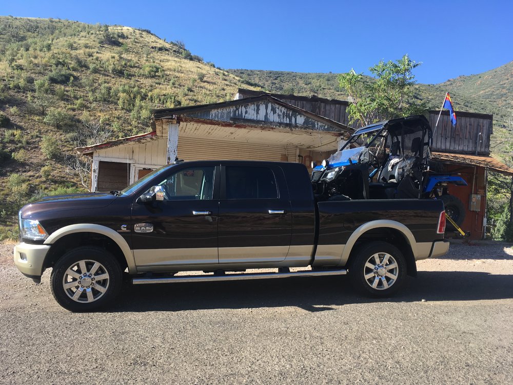

I use a pair of the 4000lb retractable ratchet tie downs to secure mine IMG 7806 they work great !
