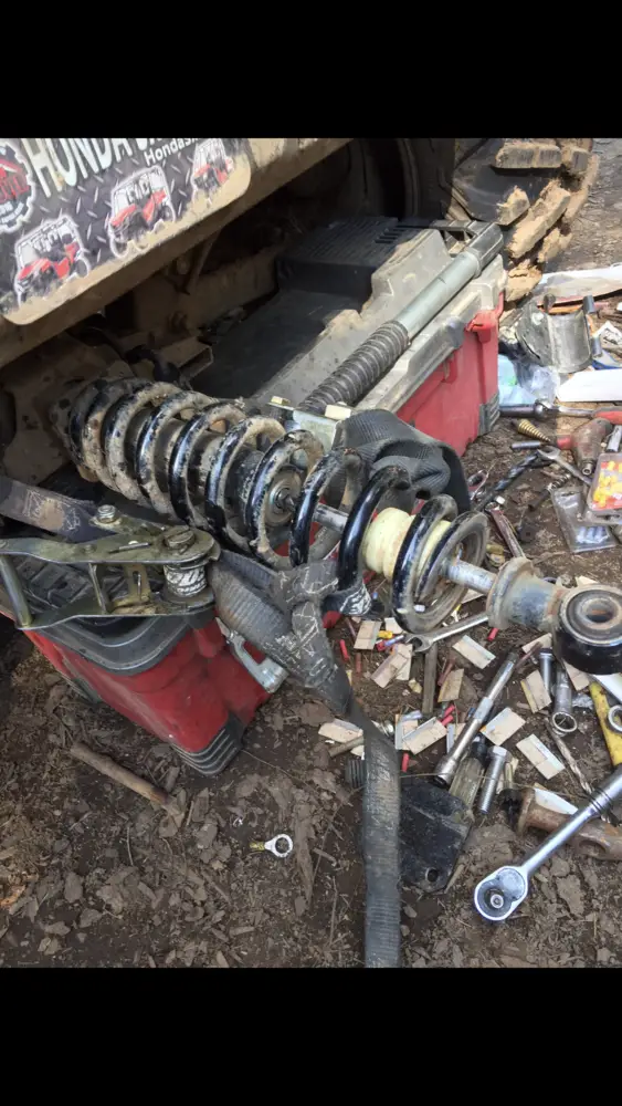

This would be the easy way to adjust! But it’s dangerous lol

I’ve done that when I did the spacers! Not too bad.

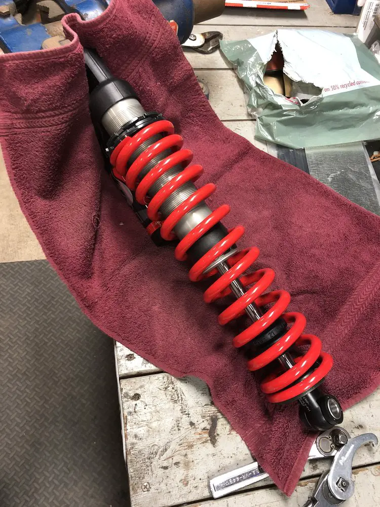

Busted some knuckles on the back ones. The fronts I just couldn’t get a good grip on anything. Soooo I took the fronts off and carefully put the end in my large ben h vice with a towel and was easily able to adjust the shock. Easy peasy
