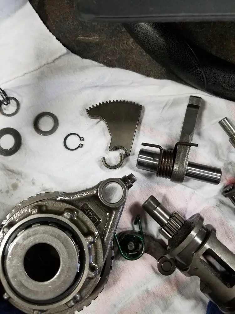

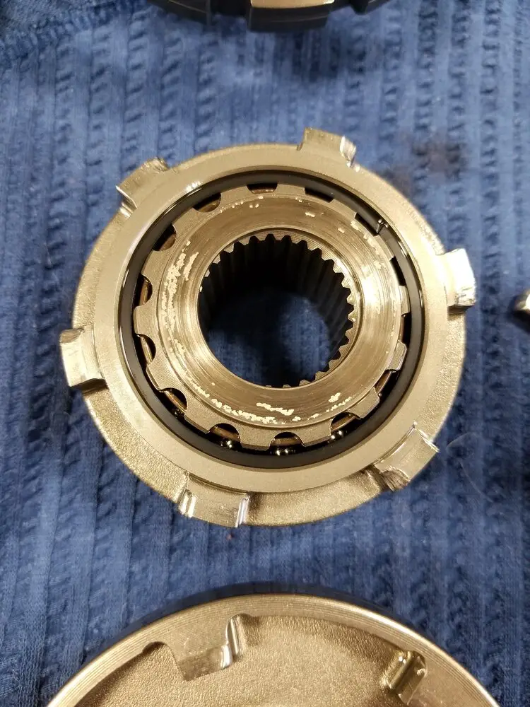

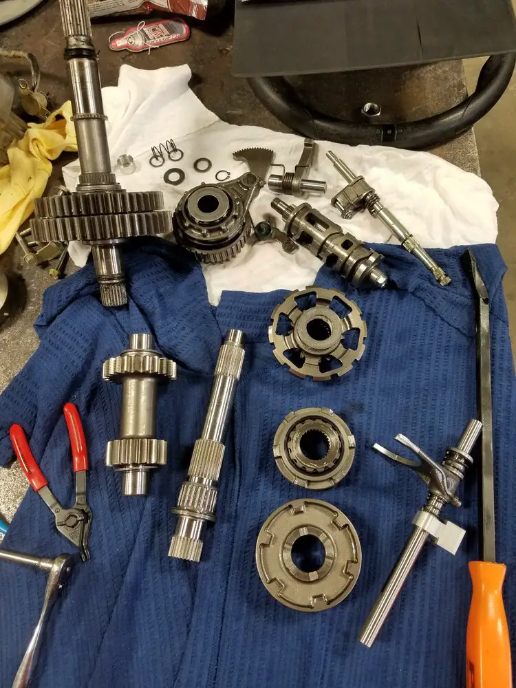

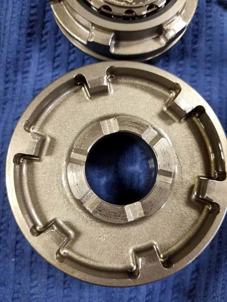

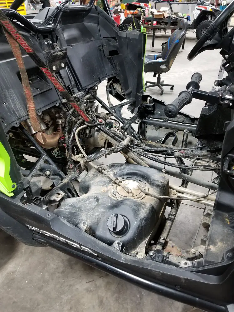

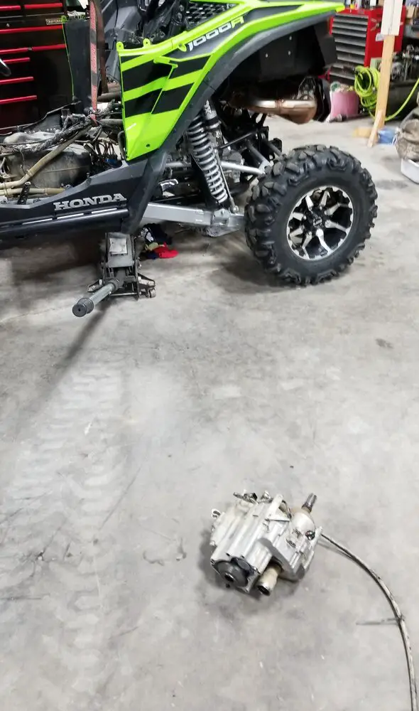

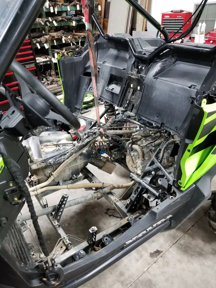

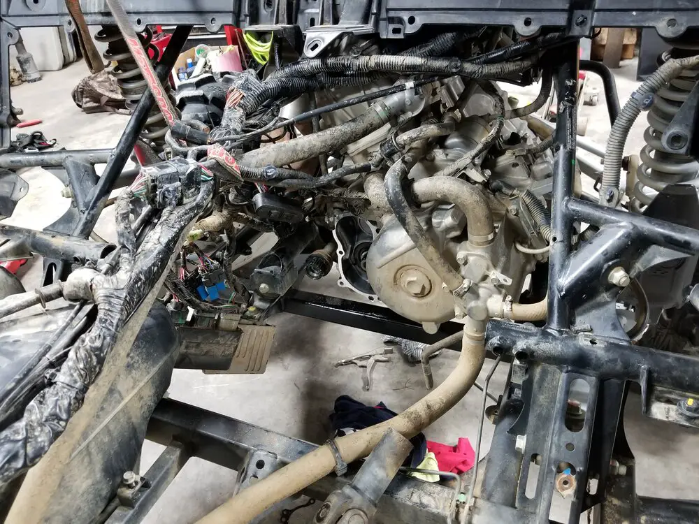

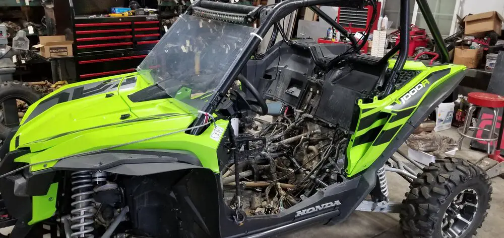

I meant to make a follow up post but forgot. I got the sub tranny pulled last spring and got it all fixed up. Before I took it to the dealer, I had it out the weekend before and hit a tree, which exploded my steering rack. It didn't bend the tie rod though which sucks because that's what's supposed to happen. Of course, Honda wouldn't warranty that which I understand. It was driver error, and I believe it didn't bend the tie rod because the way the tree hit the tire it caused the tie rod to pull away from the steering rack, not push it into it which would allow it to bend. Either way not the point of this post.
I got all the parts from Honda. I don't remember the brake down of what all was what, but it was like $730 for the tranny parts and steering rack.

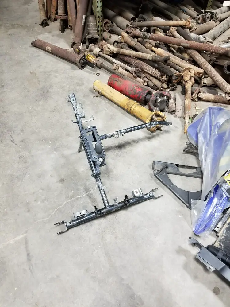

I did not have to pull the engine. It only took me like 4 hours to get down to the last item to remove which was the front drive shaft. I underestimated the difficulty to get that out. Thinking I was smarter than the service manual, I spent about 6 more hours trying to get that out doing it my way. Just follow the service manual and pull the front diff out. It still would have taken a few hours but at least they would have been less frustrating. And I found out I had to pull it anyway to change the steering rack.
Once the driveshaft was out, the sub tranny un-bolted and was sliding out Buttt.... the two studs stick out enough that the sub tranny cannot clear over the middle frame bar that's in front of it. There wasn't enough room on the stud to double nut it, so I had to use small vice grips to put in the space between the sub-tranny and tranny, and un-screw both studs that way. It felt like it took forever. Only could get like a quarter turn in each time.
After all that it slid right off.

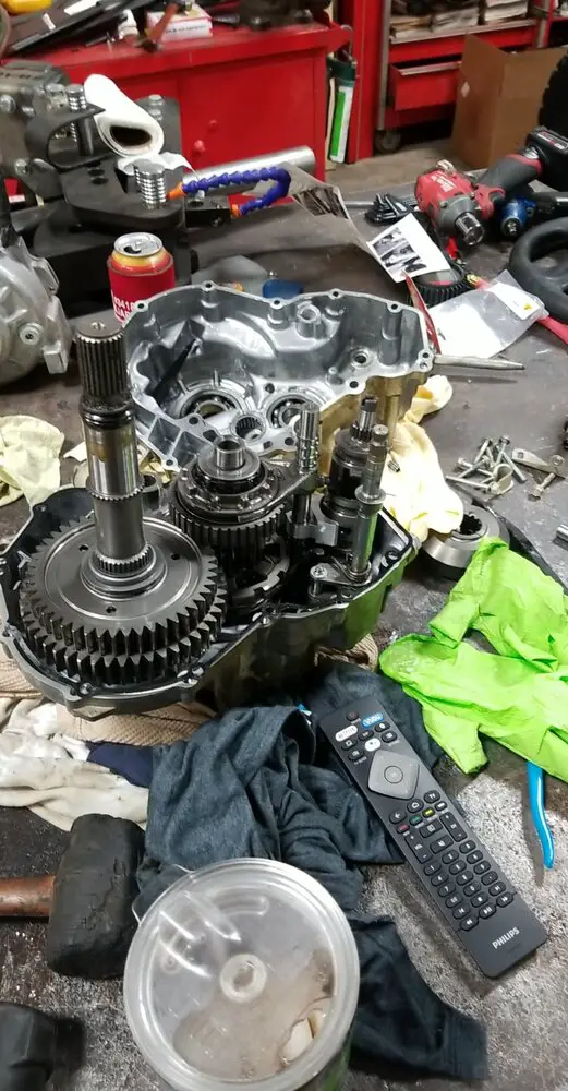

Got the sub tranny apart and you can see the dogs were worn pretty good, but not as bad as I was suspecting.

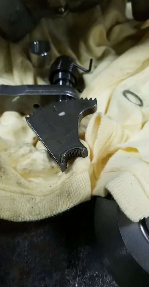

One thing I was not expecting, was the shifter part was cracked in two. I have pictures of it. I am thinking that may have been why it was not fully engaging in reverse. The way its setup in there and where it was cracked, when it was pushing for reverse, the crack would open up. Its kinda hard to explain.
Either way I got it all fixed up, back together, and she's back out running like a champ.
View attachment 250331View attachment 250333View attachment 250334View attachment 250335View attachment 250336View attachment 250337View attachment 250342View attachment 250343View attachment 250344View attachment 250339View attachment 250345View attachment 250341View attachment 250340View attachment 250338View attachment 250332View attachment 250330
I just saw this post, to anyone doing it themselves. I dont remove any interior pieces, just peel back the rear firewall half behind the drivers seat to get tot he studs and everything else can be done from underneath.
Slide the diff forward (remove both driveshaft hoops) and it'll drop out the bottom.
