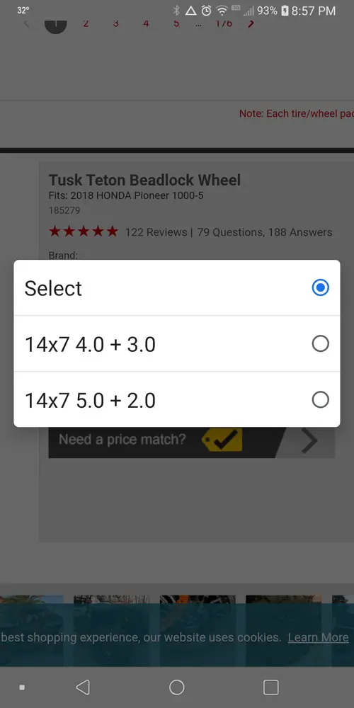

If I buy the 4.0+3.0 for the front and 5.0+ 2.0 for the back, would it eliminate needing spacers on my 2018 pioneer 1000-5 stock. Wanting to put 28" tusk terrabites all the way around. Thanks

Unless you buy 2 rear wheels with more offset and 2 front wheels with less offset you will need spacers to have the same offset front and rear. 5+2 front with 4+3 rear will be close to even assuming the back spacing is the same.

I. Agree but the 5+2 should be on the front and 4+3 should be on the back if u r using same size tire alround. If u buy 10 wide it will be about 0.6 inches wider in front than stock and 0.3 inches wider than stock in back. At least that was how it was on my pioneer 1000-3 2016

That's what I did. I'm running 15" light truck tires on 15 x 7 wheels (5+2) with a 1" or 1 1/2" spacer (can't remember) on the rears.

SDI HD9 14x7 wheels 6+1 front and 5+2 rear will maintain exact factory width. 28/10-14 Rock A Billys fit no rub under any circumstance.
