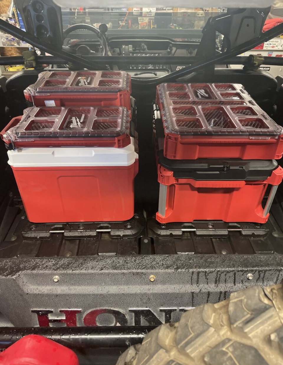

Be thoughtful of weight up top as well because you can become tippy due to overhead weight. I would also recommend checking out a bed extender and maybe interior door storage mod (if the 22 has that?) to keep weight low.
20,161
115,316
Pack-outs in the bed as well.
